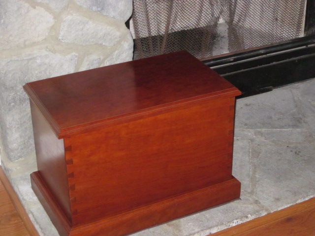

I second this.   Four or five years ago, I made a "keeping chest" (sort of like a blanket chest but smaller) for my wife.  I had one nice board and planned so I could get it all out of it.
In an experiment, I put on a coat of BLO and took it out to the patio in the summer sun during the days for a week.  Not only to help cure the BLO but to give it some sun exposure.   Then I applied a few coats of SealCoat.   BAM!  It seemed to get 10 years of patina in a week.

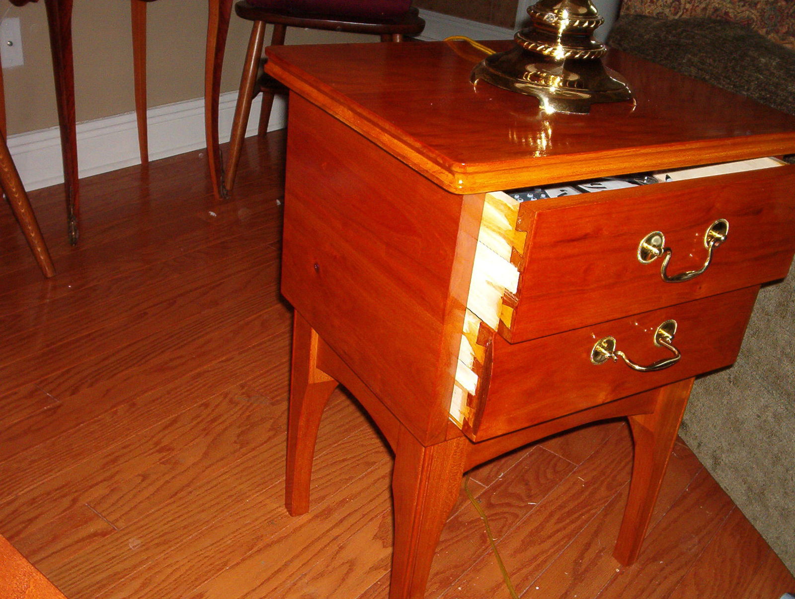

Several years ago when Steve Mickley was the Wood forum finishing guru I did a entertainment center and asked him a lot of  questions. Best finish on cherry he said is BLO as stated to pop the grain. By the way this works on most woods with good grains but do expect a reasonable amount of darkening. Then use the garnet shellac to even out the color of sapwood and heartwood. This is not a perfect solution but does work . Then as Keith said you will get tan lines in  time if it is a table or holds something.
I do not have a current pic of the side tablet I built but finish is totally garnet shellac in a french polish. In the same room is a entertainment center with garnet shellac and varnish. The entertainment center has darkened significantly and the side table still looks red like the shellac.IMG_0433.JPG.a0c9e933c92ad3861d4abf9bd4391fb6.JPG
New finish on Entertainment Center
Behind my grandson is the same door panel after 13 years.
This is the side table. No current pic but after 14 years is no where near as dark as the entertainment center and was made from the same batch of cherry.
