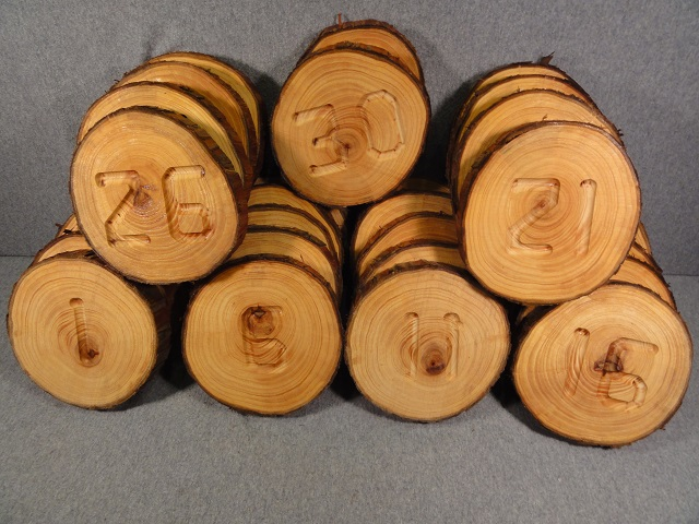

I did some Cedar log slices.  I cut them into these discs while they were still wet.  The moisture was visible so I let them go until the wet look disappeared and then soaked them down with wipe on poly until they looked shiny wet and let them go a couple days and soaked them again.  Might have been luck but not a one cracked.  Routed the numbers into them a few weeks later and then brushed poly into the numbers.
