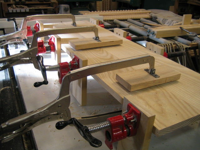

Pat Meeuwissen Posted February 10, 2020 Report Posted February 10, 2020 (edited) Jess, if I can ask how do classify what type of frame goes with what kind of puzzle? To busy gluing to make more progress on the new one. LOL By the way like the look of those blocks you added to the pipe clamps, I assume that's to make them all stand up easier and not to crush softer woods. Edited February 10, 2020 by Pat Meeuwissen addition Gunny and Cal 1 1 Quote

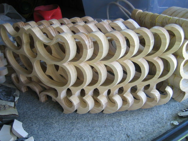

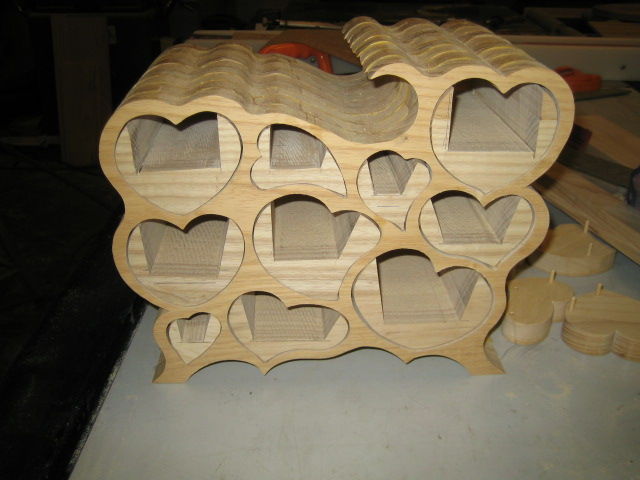

Smallpatch Posted February 11, 2020 Author Report Posted February 11, 2020 I needed to raise the pipe clamps up so I have room underneath the wood laying on the pipes for the other jaw of the vise grip . I built these long ago and are only used when I'm edge gluing boards for wider projects.. This picture shows better than I could tell... I use vise grips when making these scroll saw jewelry boxes. So when I edge glue boards the pipe clamps on stilts is to get the vise grips on each side of the boards to be edge glued. These drawers are about 8" deep and I use 9 clamps at a time to make sure all these pieces are pulled down tight for I glue one at a time until I get all 9 or 10 scrolled pieces glued together...I use 4 3/16" dowels between each piece so I can get all pieces lined up exactly or I might end up with very wide gaps when I finally get down to putting the drawers together... I glue up the cut outs from the body and the V18 SP vise grip is the only tool I can get to spread that wide. So when I need to edge glue pieces together to cut out the bodies I want the flat boards to line up perfectly when edge gluing and these pipe clamps I needed to raise off the table enough to get the vise grips under the boards for these special long attachments I added to some other vise grips for clamping the flat boards together while the glue is setting up. I bought some white plastic cutting boards from Walmart and attached some strips of the plastic to the inside of the clamp jaws so they would not stick to the boards being glued if glue happens to get between the boards and the clamps. These are not band saw boxes. It takes about 50 times longer to make one of these and are more exact and less gaps between the drawers and the box body... These pipe clamp stands or what ever one wants to call them are just what I needed for edge gluing so I would not have to waste a lot of wood running the glued up boards through the planer... so the clamps on each side of the boards keeps them lined up as close together as I can get them as the glue is setting up. If one wants to build some make sure all boards are exactly the same length then build a jig so all the holes are in the same place and I do all my edge gluing on the big table saw so every thing is flat to start with. I don't work with soft wood if I have to run the wood through the planer or any of the sanders or drum sanders for soft wood ruins the sand paper big time and it take too long to change paper so I only use soft wood for picture frames or small items that don't need and sanding except the small electric sanders. I use more vise grips than any other clamps except the black harbor freight spring clamps and I got many many of them.... Artie and Cal 2 Quote
