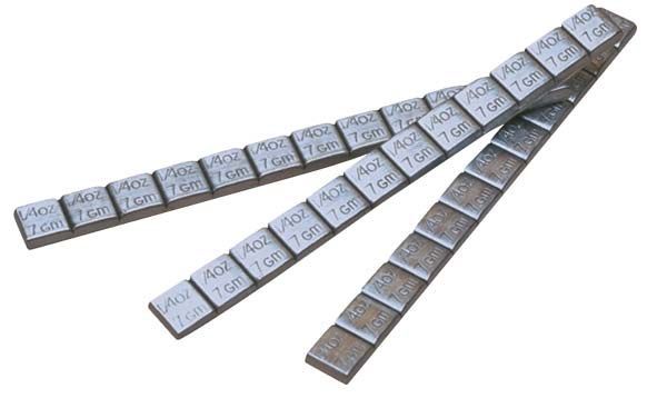

January 19, 20206 yr comment_215942 33 minutes ago, BillyJack said: I would mount plywood with some adjustments for balance. Make bigger holes for adjustment.. too far out of balance could hurt the bearings. That is one way of doing it, and it will work. If you do not want to add the plywood you can balance the wheel as is using stick on wheel weights. They come segmented in .25 ounce sections but are easy enough to cut down to a smaller weight. I would not buy a box of them but any auto repair place that has a tire machine will have them. Just ask, I have several customers that come in and want oddball stuff we toss away or have millions of. Report
