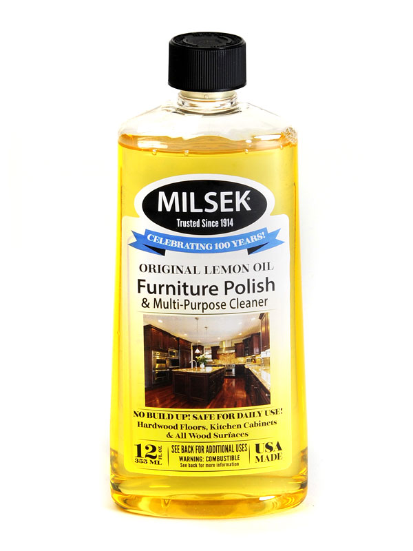

January 15, 20206 yr comment_215551 I have used Milsek. It is thin and may be thin enough to put in a spray bottle. There is plenty of video on YouTube for homemade furniture polish. Seems olive oil and vinegar are the main ingredients. Report

January 16, 20206 yr comment_215626 15 hours ago, BillyJack said: I see the olive oil but confused with the vinegar Milsek and most other brands are a polish and cleaning solution. Report
