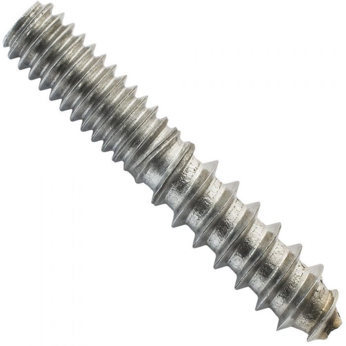

December 29, 20196 yr comment_213786 What is the thread size. I have one that is 1/4" coarse threaded to accept a hanger bolt and other. The other one I have has a short 3/8" NF thread to accept drill chucks. There are other sizes out there like this 1/2" NF Edited December 29, 20196 yr by HandyDan Report
December 29, 20196 yr comment_213859 8 minutes ago, Woodbutcherbynight said: This is what I have. That should be threaded into the mandrel. It is not much thread and should be removed and replaced with a hanger bolt. You may have to modify the length some. I have one just like it and the threaded hole opens up other possibilities for it too. I mounted a 1/4" stud in it to turn the each yo when I was making yo-yos. Report

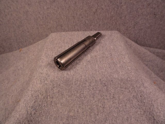

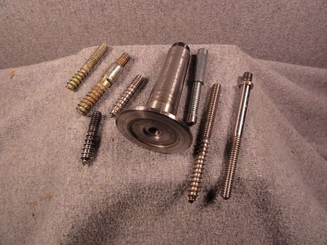

December 31, 20196 yr comment_213984 On 12/29/2019 at 4:31 PM, Woodbutcherbynight said: Thanks for the tips, I originally bought a JET 10x12 lathe and made pens, and nothing else. For many years this supplied me with slushy funds to buy more tools for the shop. Couple years ago I bought a Nova Chuck and played with it some but having started with pens I love the mandrel going down the center. Got a picture of mine today with some of the screws I have employed in it over the years. I do have four or five pen mandrels too. they are quite handy for other things too. Here is another type to keep an eye out for too. It is a #2 taper and will grab onto a 5/16 bolt and hold it perfectly centered. It is basically a collet and the hold comes from the taper driven deeper in the spindle. I also have a collet chuck which is the most versatile. Report
December 31, 20196 yr comment_213985 The one with the MT needs a draw bar to keep it in the headstock without wobble or being pulled out. Not sure what these MT screws are called but usually the screw is called a worm screw when used in a chuck. Report
