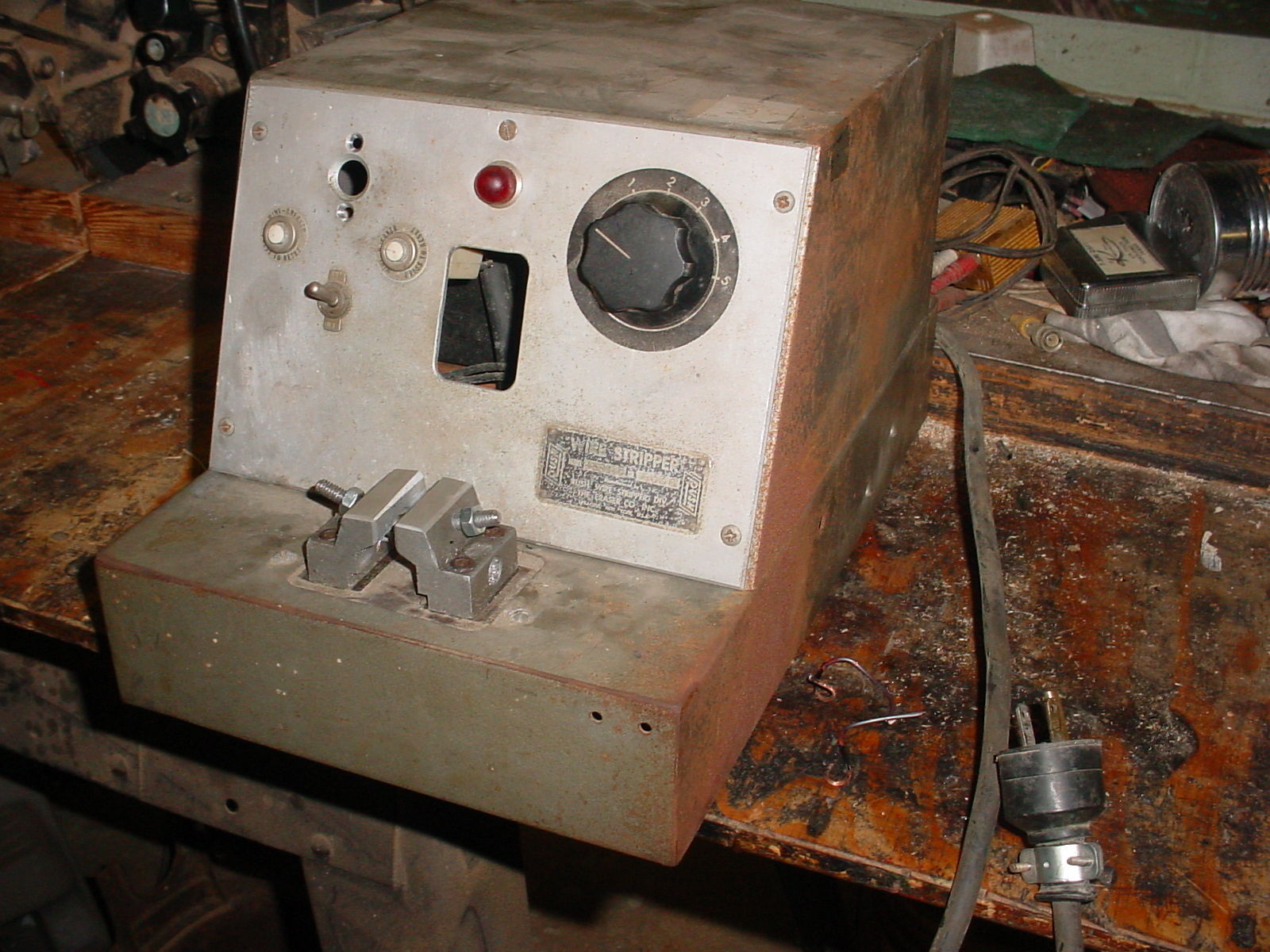

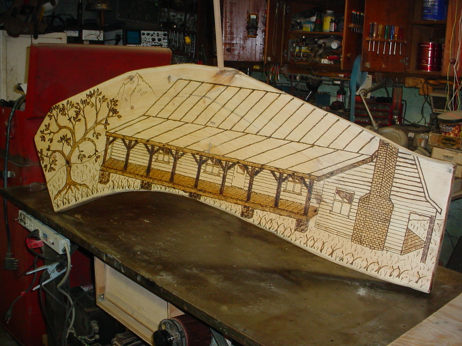

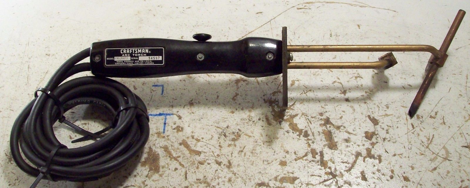

March 1, 20206 yr comment_220160 Sure thing... I used a Variac transformer to control my heat. I used a carbon arc torch for my pen. And I used a wire stripper transformer for my power supply. It's fast and strong. No waiting around for things getting hot. I've done a lot with this unit and I'm real happy with it. I also make my own Nichrome resistance wire tip for the pen. Report
