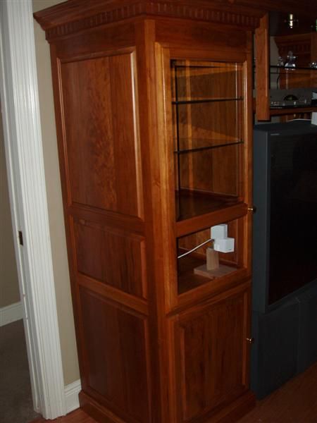

December 17, 20196 yr comment_212693 I have a entertainment center I did the same and used the plastic clips inside. The Picture is before I put the speaker grill cloth in. Report
