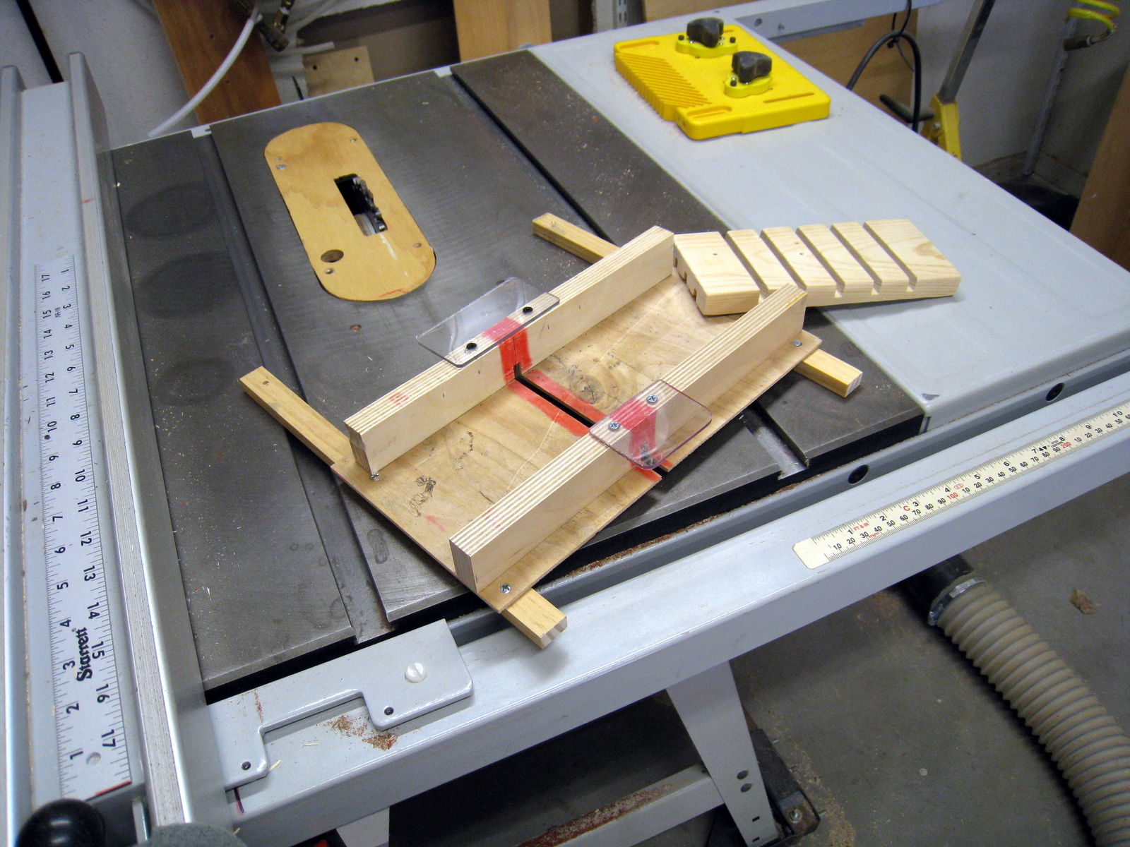

I needed a small TS sled for about 50 crosscuts with the dado (sample piece in pic to right of sled).  I have a full size sled (somewhere), but it struck me that a small one for just this one purpose was worth the time. The runners don't quite fit exactly in the slots:  they're slightly deeper than the slots, so the bed of the sled hangs a fraction above the TS top (I just push down).  The screws are a little too long and rub on the bottom of the slots.  It's all from scraps, including the plastic safety guards (I like my fingers;   I think I'll keep them).  For something tossed together it sure worked well.    Pretty don't count.

It just has to work for the job intended. After that its just for show and tell...

whatever works is golden.
It works and for a one off job nice.  Did same for some 2x4 legs for my sawhorse build.
