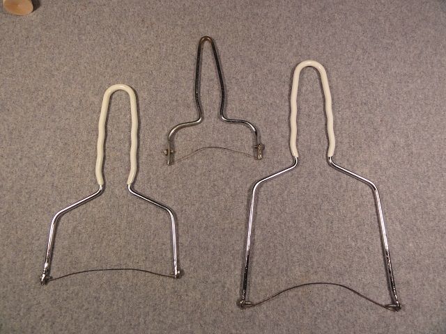

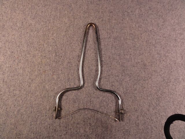

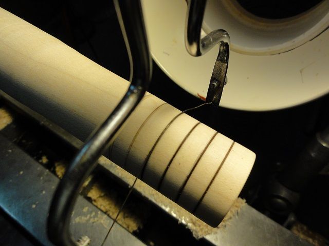

November 17, 20197 yr Popular Post comment_209007 When I do burn lines I use the tip of the parting tool laid on its side to make the groove for the wire. I use the lower edge and it slices into the wood rather then tearing into it. I found that if I use the skew the groove would be too thin and too deep if I tried to make them wider. When I have a lot of lines to do on multiple items I like to make a witness stick for marking where the lines go. I mark off how many lines I need and then put a small notch at each mark for the pencil tip to lay in. Makes for quick and easy marking. Guitar strings make the best wire as they last the longest. I also use mig welding wire which does a fine job and lasts much longer than a common steel wire or copper wire. The way I hold the wire is a bit unconventional. I employ a cheese slicer frame and made larger frames out on turkey lifting forks. I can use both hands on them for more control and don't have to reach over the turning like is done if both ends of the wire need to be held. I can also squeeze the frame together making the wire looser and contacting more of the piece. I drilled and tapped the ends of the forks so the wire can be replaced when needed. This has been working very well for me so I am sharing with you. I was talking with Stick about it recently and he suggested using a fret saw and the wire could be clamped in the same as a pinless scroll saw blades are. Edited November 17, 20197 yr by HandyDan Report
