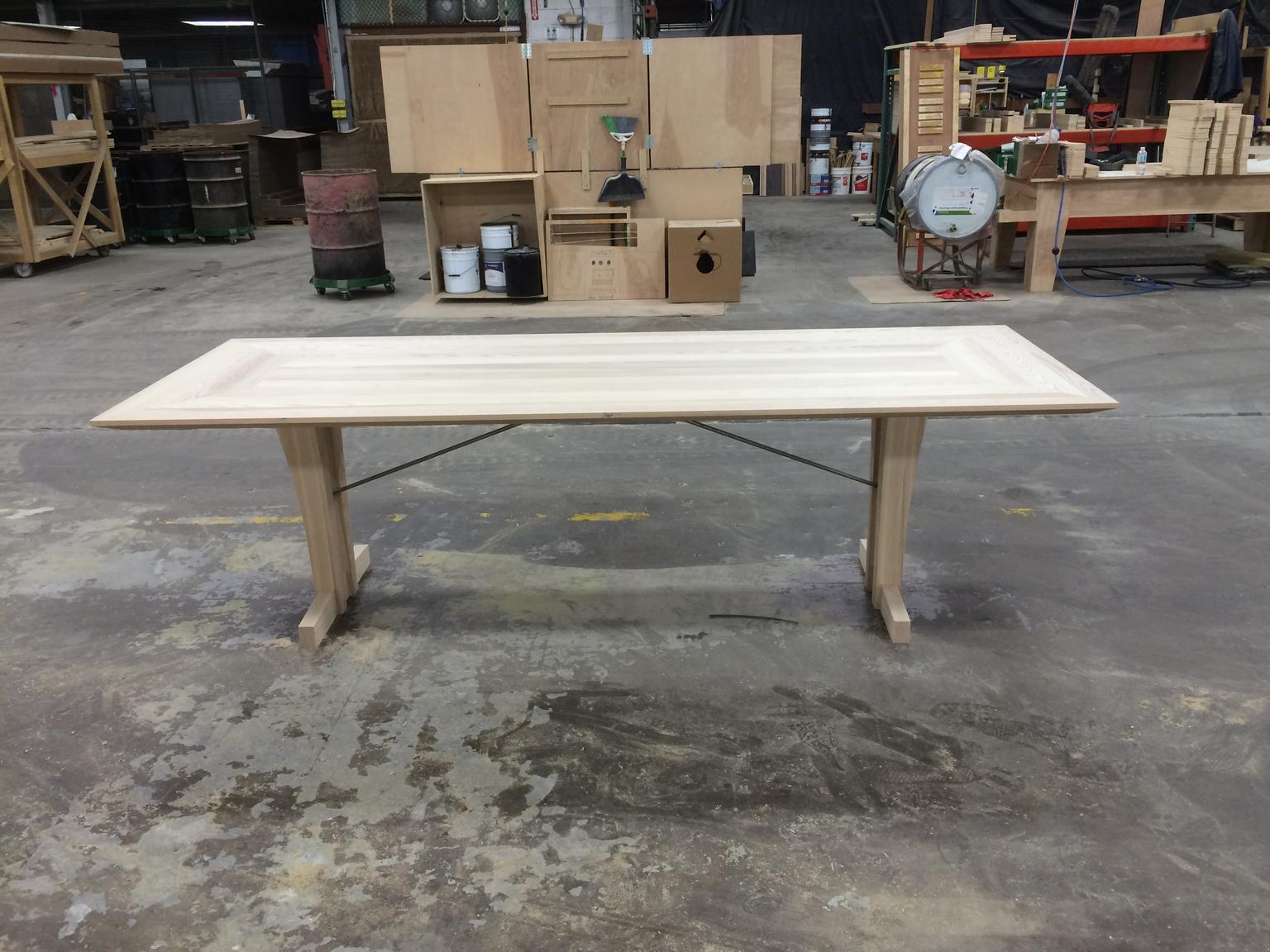

November 12, 20196 yr Popular Post comment_208500 You have a lot of options on these tables just use the one that works best for you...9 Edited November 12, 20196 yr by BillyJack Report
