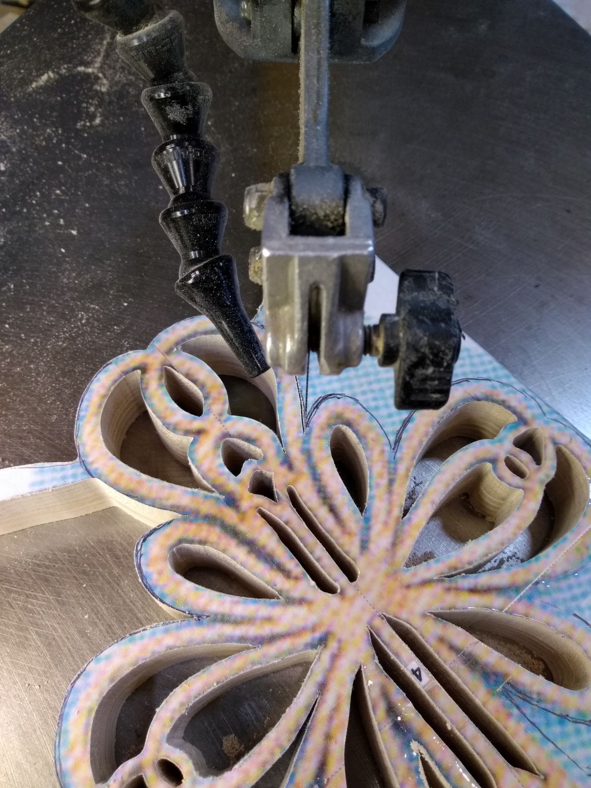

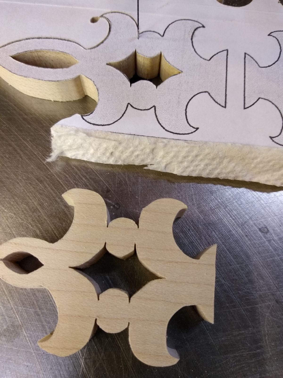

November 11, 20197 yr Author comment_208407 Artie I was cutting this stuff this morning and want to show you something...you might already know but since I don't follow the line in certain places it might help you sometimes. This area where I stopped the blade it shows where I went on past where the line curves around and loops around to the next turn. Okay when I start the saw up again I will back out and turn the blade around and go into the bottom of the cut and complete the curve to the next bottom of the curve. I don't swing the blade around like it shows because a person can't always swing that sharp and will make all those same looking curve all look different....Also you can see how I made the circle on top of the very sharp bend... going on out past the line then swing the blade around anywhere in wood that won't be used then I have my blade going into that sharp point like it is supposed to look. I have a distance to get the blade going the direction I want before I get to where it counts and will show. Anywhere I have a sharp I go past the end of the line maybe eve 1/8" , back out and swing the blade around then back all the way into that deep V and then start going out the other side of the v. These pieces are part of these things in the next picture and might not show but they will for folks inspecting your ability ... Report
November 11, 20197 yr Author comment_208408 The people that drew these plans up recommended using a #9 blade.. I doubt if they are wood workers and only know how to draw up plans!!! Report

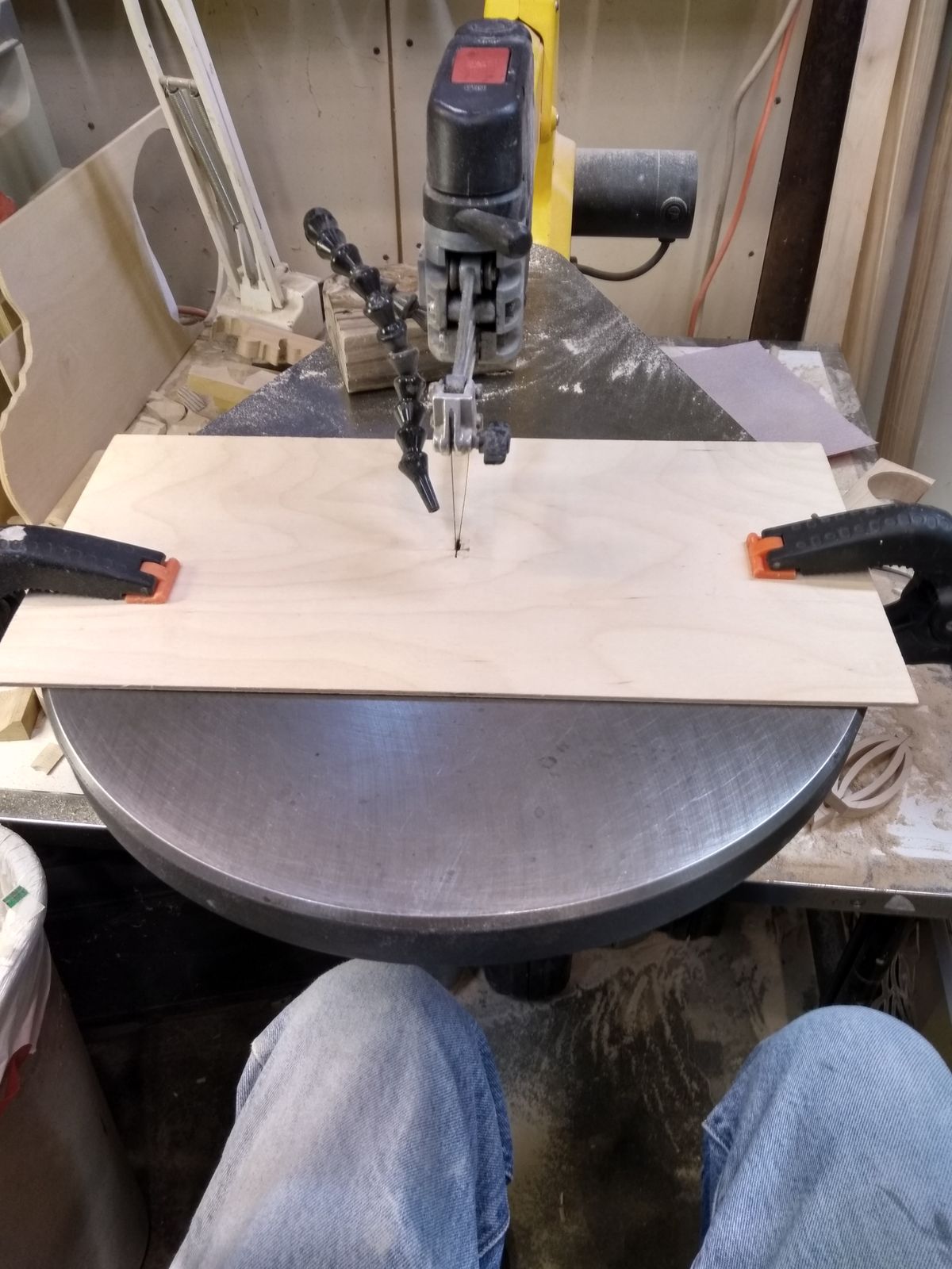

November 11, 20197 yr Author Popular Post comment_208409 You might already do this. But if you don't? When cutting really small pieces that might get broke and fall through the hole and get lost. Report

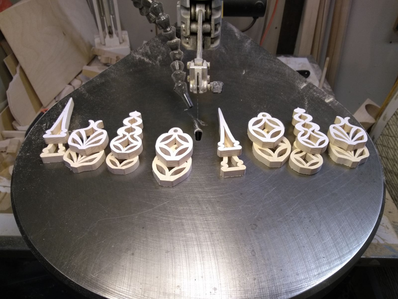

November 12, 20197 yr Author Popular Post comment_208447 All the years I been scroll sawing I don't ever remember keeping time on how long it took to cut out things... well today I got the clear tape on the board and sprayed the stickup and when I finished it was 2 hours for this much sawing. And when all this is put together and finished it will only be 2 compound tree ornaments. And if I hadn't have stack cut them it would have taken 4 hours...Lets see now, woodworkers hourly pay is around 2 dollars an hour so...……. Report

November 15, 20197 yr Author Popular Post comment_208860 Artie if you do need to saw real small items do use the inserted board but also use some real small toothed metal cutting blades . They have no reverse teeth and those teeth pointed up are the ones that grab the wood and send it flying up at you. A person can cut the man out of the old style dimes and use the outsides for necklaces using the metal blades. The key here is to glue the dime on to Baltic Birch plywood first. Report
