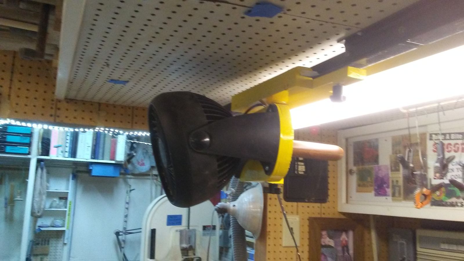

November 7, 20197 yr comment_207903 2 hours ago, kmealy said: 4. BOX FANS ARE BEST Forced air and ceiling fans will be nowhere near as effective as directional air flow that you can achieve with a cheap box fan. Set these fans on a low to medium setting for a gentle breeze. Good idea and also good for keeping the shop cooler in summer. I got a smaller 9 inch one but mounted it just over my head on some garage door opener T track. Allows me to keep it out of the way when not in use, and pull it to where I do need it when the time comes. Just throwing this out as an idea for what to do with the fan other than put on workbench. Be creative.... Report
