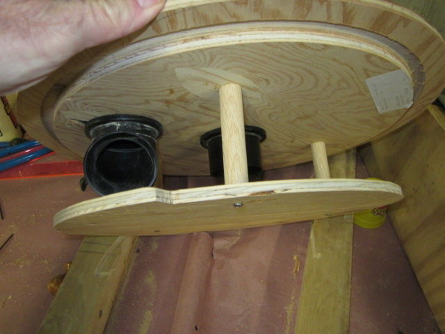

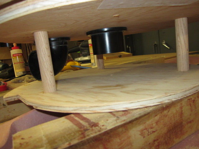

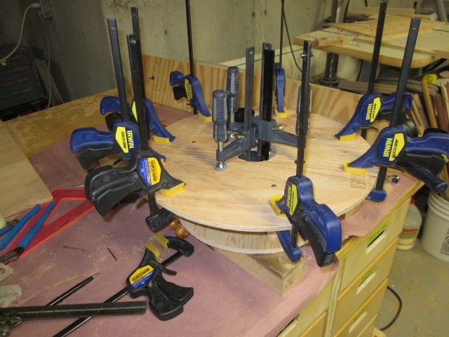

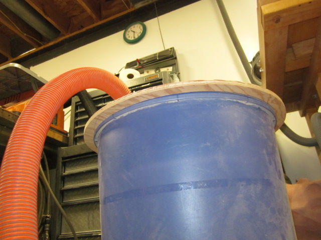

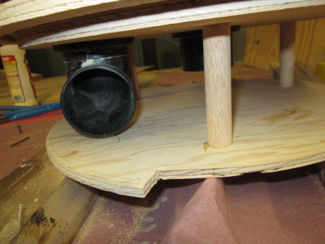

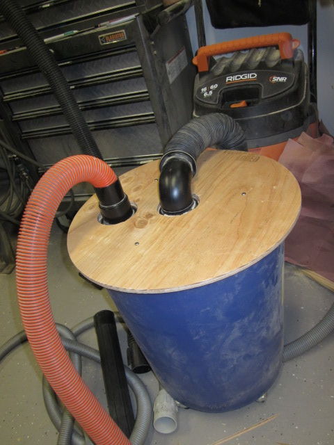

November 1, 20197 yr Author Popular Post comment_207244 Made from salvaged plywood, leftover dowel shorts, and connectors from the original top. Next up is a similar set up for my 30 gal garbage can and 4" dust collector hose. Glue up Overall photos In action Report
