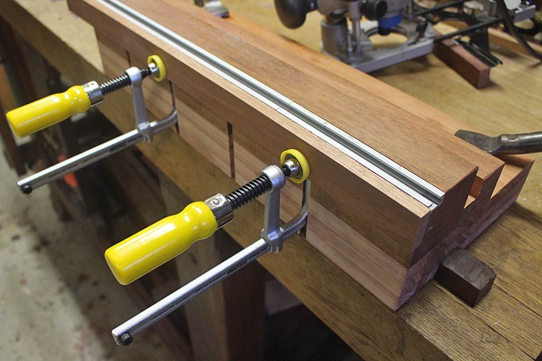

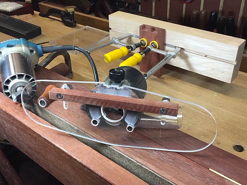

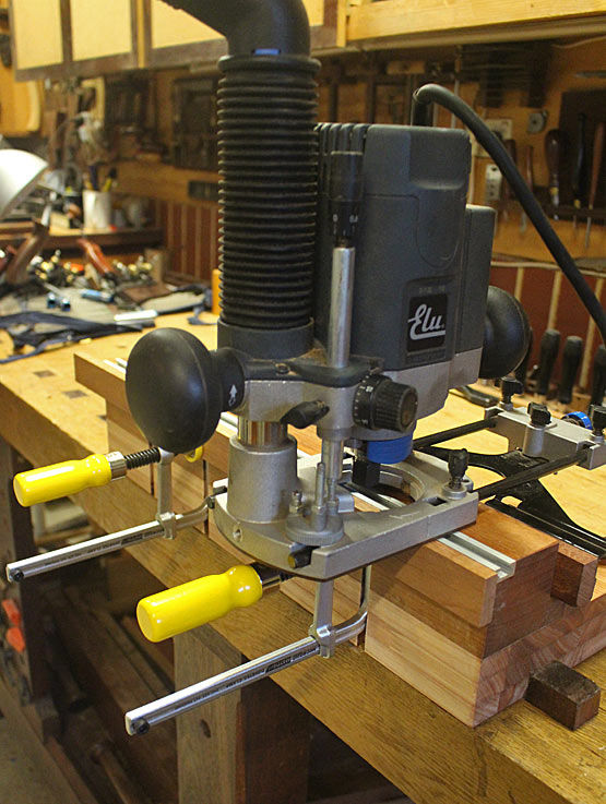

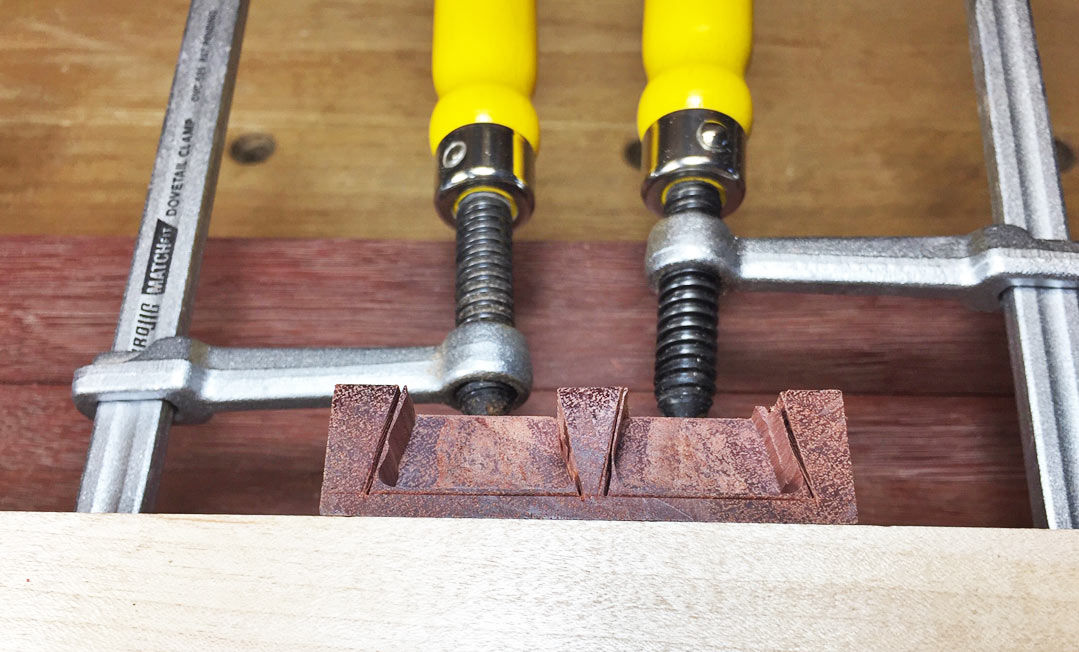

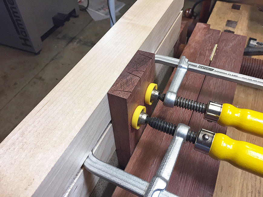

November 20, 20196 yr Popular Post comment_209455 I use the Matchfit clamps on a number of jigs. As you are aware, they fit into sliding dovetails. Morticing fixture ... Clamping stretcher ... Morticing ... Moxon vise ... ... has a flip up spacer with hold down ... Fixture for routing waste from half-blind sockets ... Regards from Perth Derek Report

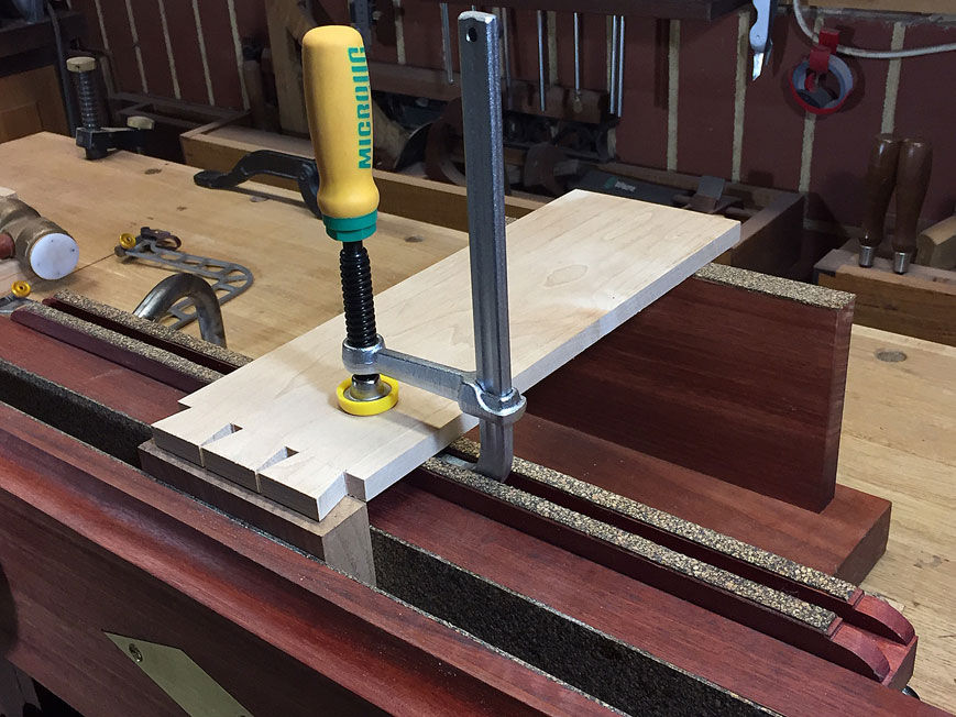

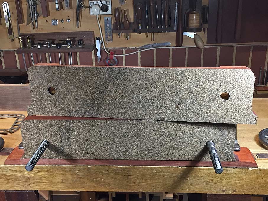

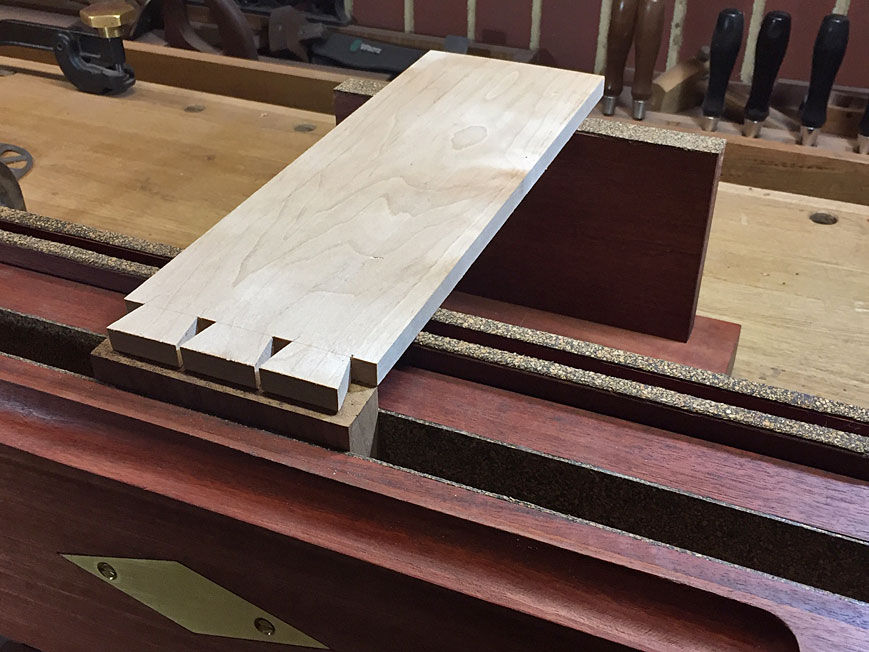

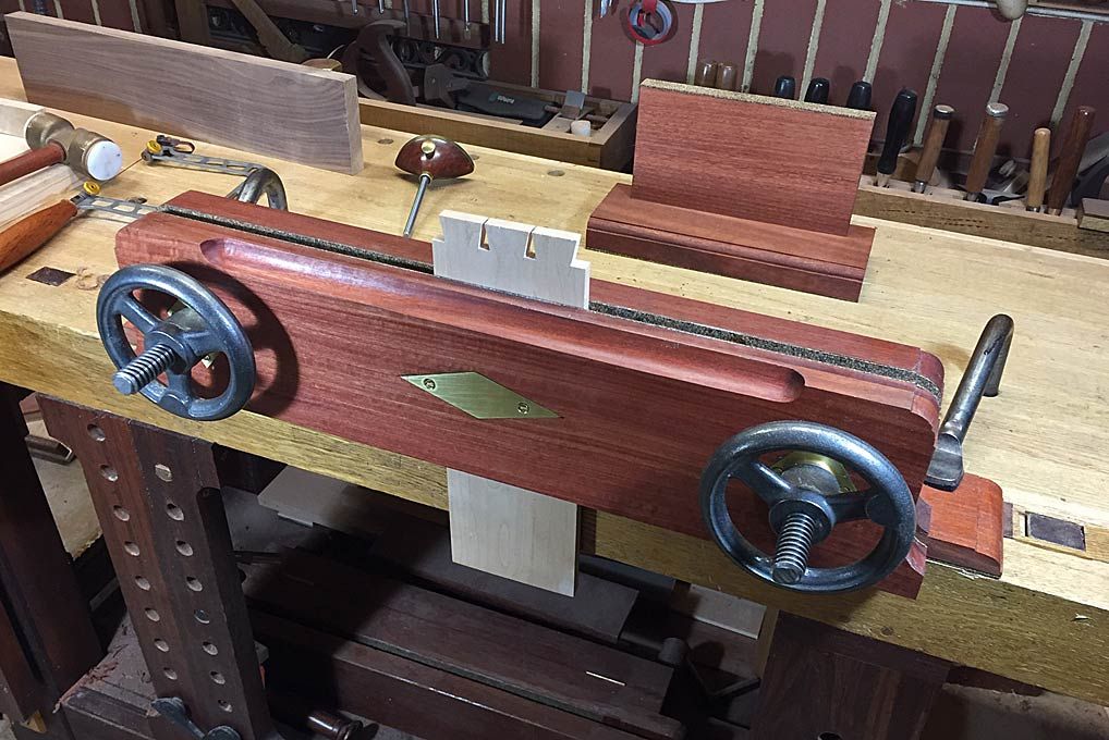

January 30, 20206 yr comment_217007 On 11/20/2019 at 8:33 AM, derekcohen said: I use the Matchfit clamps on a number of jigs. As you are aware, they fit into sliding dovetails. Morticing fixture ... Clamping stretcher ... Morticing ... Moxon vise ... ... has a flip up spacer with hold down ... Fixture for routing waste from half-blind sockets ... Regards from Perth Derek Derek, couple questions if you have time. The setup on the Moxon vise why did you add the cork? strips on top? Second was thinking of getting the vacuum attachment for my Bosch trim router, how does it perform and is it pretty universal fit for any trim router ( also have DeWalt version)? Thanks Pat Report

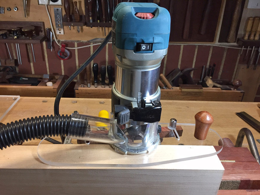

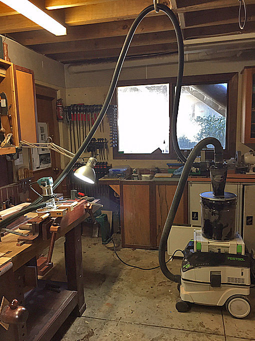

January 30, 20206 yr Popular Post comment_217021 Quote The setup on the Moxon vise why did you add the cork? strips on top? Second was thinking of getting the vacuum attachment for my Bosch trim router, how does it perform and is it pretty universal fit for any trim router ( also have DeWalt version)? Hi Pat The inside ... ... and the top ... ... have Crubber (rubberised cork), as a non-slip. This is all fully documented in my article, The Last Moxon Dovetail Vise: http://www.inthewoodshop.com/ShopMadeTools/TheLastMoxon.html The details for the Makita trim router in use are here: http://www.inthewoodshop.com/Furniture/PowerRemovingWaste.html I have doubts that this base would fit a Bosch. The Makita is really excellent. The dust control is close to 100% using a Festool CT26E. This is the set up ... Regards from Perth Derek Report

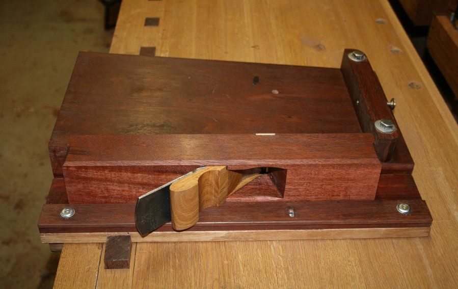

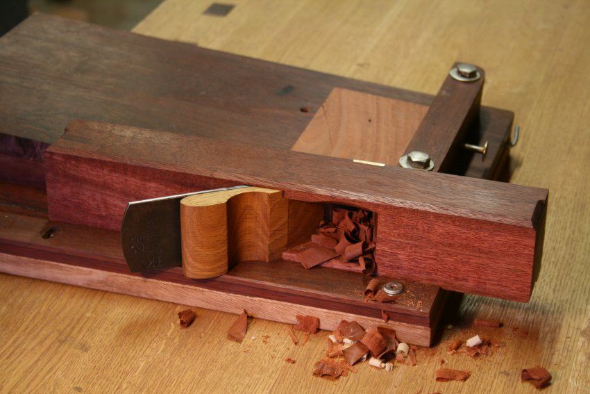

February 3, 20206 yr comment_217446 Pat, the short answer is that the hot dog has a set screw to tighten it down. The longer answer is that a hot dog is not needed on the LA Jack. Read here: http://www.inthewoodshop.com/Furniture/ShootingPlanesCompared.html The hotdog does not fit a Stanley Bench Plane. The frog gets in the way. Have you considered building your own shooting plane? Make a strike block plane: http://www.inthewoodshop.com/ShopMadeTools/BuildingaStrikeBlockPlane.html Strike block plane on a ramped shooting board (both in Jarrah). The Jarrah for these came from roof beams. You can use any hardwoods you like. It does not cost money, just time and sweat. Regards from Perth Derek Report
