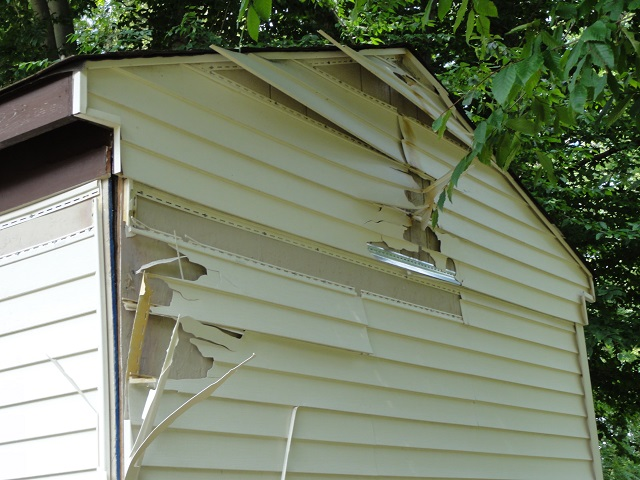

October 23, 20197 yr comment_206166 This picture is from a few years ago. This shed is not wired for electric. It is beneath a large Beach tree which was not affected by the lightening. The lightening did travel to the next shed which is wired for electric and attached to the pole style building I use as a metal shop and tripped the breaker for the garage door opener in that building. It then traveled 75 feet to the house and put the portable phone out and burned the switch on the surge protector strip for the computer equipment. It did its job and the computer was fine. Lightening doesn't happen often but sure does weird things when it does. When I replaced the siding on the shed I had to cut it into smaller pieces to set it out for the trash. It would not break by bending it but the lightening blew little pieces all over the yard. Report
October 23, 20197 yr comment_206172 29 minutes ago, HandyDan said: This picture is from a few years ago. This shed is not wired for electric. It is beneath a large Beach tree which was not affected by the lightening. The lightening did travel to the next shed which is wired for electric and attached to the pole style building I use as a metal shop and tripped the breaker for the garage door opener in that building. It then traveled 75 feet to the house and put the portable phone out and burned the switch on the surge protector strip for the computer equipment. It did its job and the computer was fine. Lightening doesn't happen often but sure does weird things when it does. When I replaced the siding on the shed I had to cut it into smaller pieces to set it out for the trash. It would not break by bending it but the lightening blew little pieces all over the yard. Wow. That is truly scary. Report
