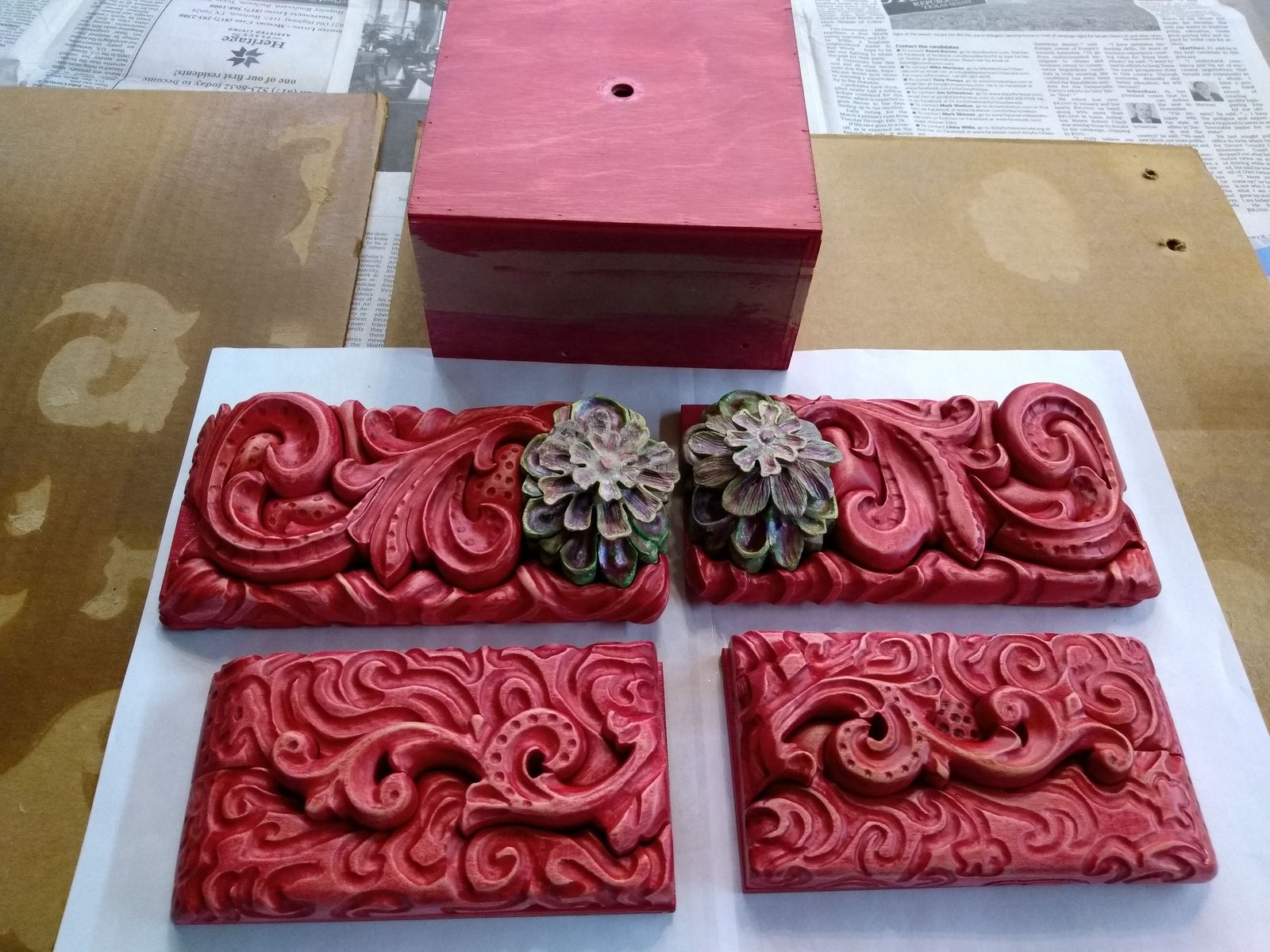

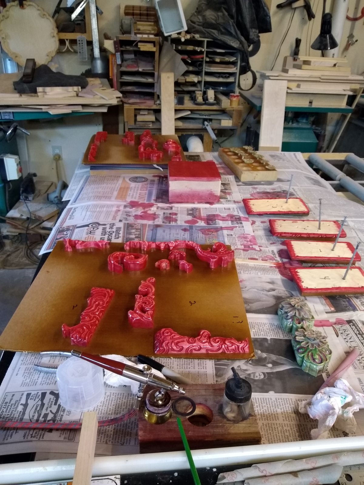

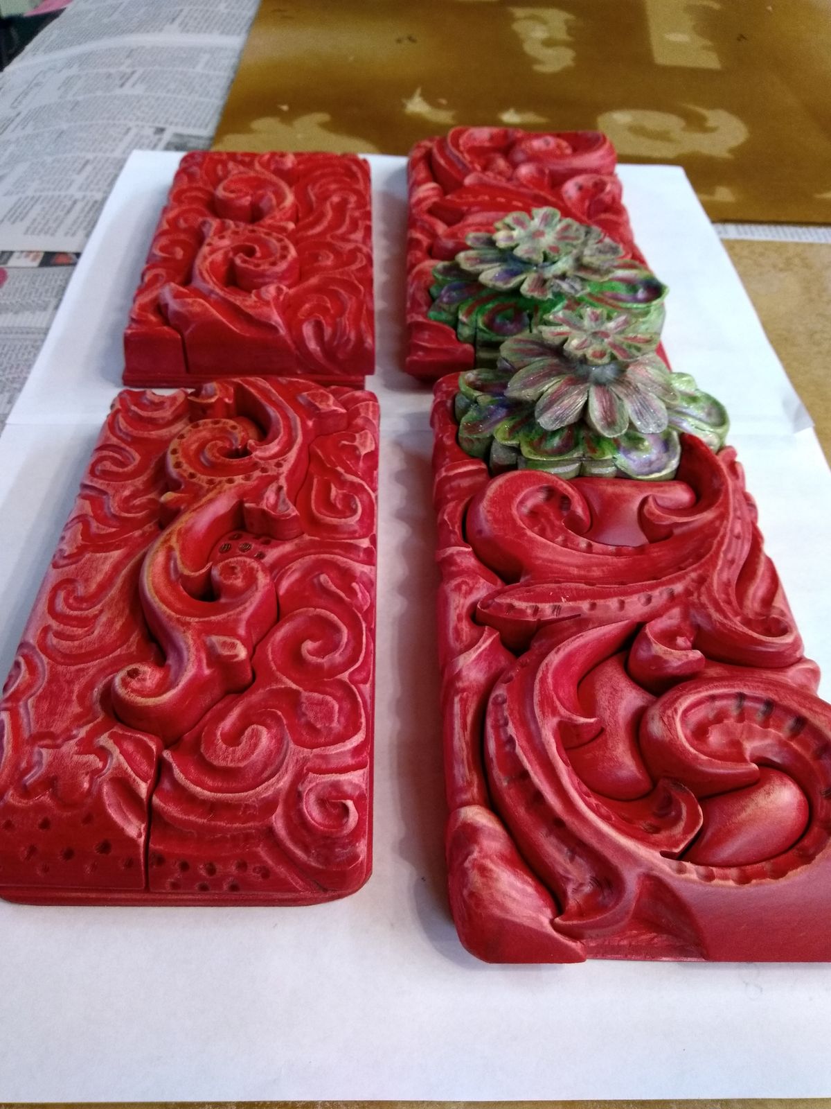

October 9, 20197 yr comment_204506 Been so busy ??? Don't remember what it was I was doing but it wasn't in the shop.. Staining Then spraying some clear. This should come close to matching her new car. Trying to find some 1/2" wide painters tape but none in a few places I have looked.. I did need some 1/4" wide painters tape for a special project some time ago and had to order one roll from the internet.. The freight was more than the tape cost. This is a project with no drawings before I starter to guide me. Jut to see how much longer it would take me trying to think and saw..!! Report

October 10, 20197 yr comment_204542 The projects look good up there Jess. How much cleanup is there on the airbrush when you are done? 10 minutes, 30 minutes? A little late in the game now for your tape needs, but a couple alternatives. Most good auto supplies should carry pinstripe in various widths, some of that stuff is pretty flexible and stretchable and might serve your need. For the 1/2" tape, how much do you need, and how flexible? If you are not shaping it to a multiangled surface, you could ask at a vinyl shop, sign or t-shirt shop for them to cut a piece of vinyl at 1/2" to the length you need. Just a 1/2" stencil would be the result. Report
October 10, 20197 yr Author comment_204552 Cal the air brush is not that hard to keep clean. When I get through using it I run a little lacquer thinner to clear it out then leave it full of thinner sitting on the shelf. About three weeks ago I still had not run the thinner and it took a little extra time to get the spray to widen out like always...Plus I have been spraying that water base stain and the glitter settles so I also clear it out with lacquer thinner also... I don't know if anyone does what I do and that is mixing lacquer base stain with water base stain. I do this sometimes for certain colors and there is a problem with it mixing and the stain will get like clabber milk…. I have never let this out but to get the two to mix like it should then instead of using lacquer thinner switch over to acetone and wa la the two different base stains will mix. I doubt if the know it all paint masters know this..... When the two clabbers just add some acetone and the mixture will smooth out...my little secret. Report

October 11, 20197 yr comment_204690 That is an interesting concept to mix the lacquer and water base stains. Had you asked me if it could be done I would have said no way, now I will have to say that I have heard it can be but I've never done it... What is the effect you get from mixing like this? Report

October 11, 20197 yr Author comment_204726 Cal I needed a brighter red and I decided to use printers ink yellow which is water base and when I mixed it in with a dye stain lacquer base red stain it clabbered up and looked terrible in the baby food glass jar. I then got the acetone and poured it in over the clabberd mixture and and it smoothed out and this is what I used. After the stain dries I use the all pro 3m 200 grit to sand off the edges to make it look like this is an older finish like people almost wore the paint off keeping it clean! Maybe she will use it as a hood ornament on her new red SUV. It should match the color maybe! Report
