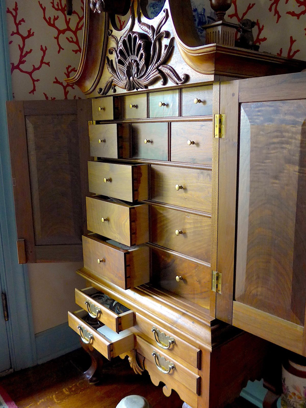

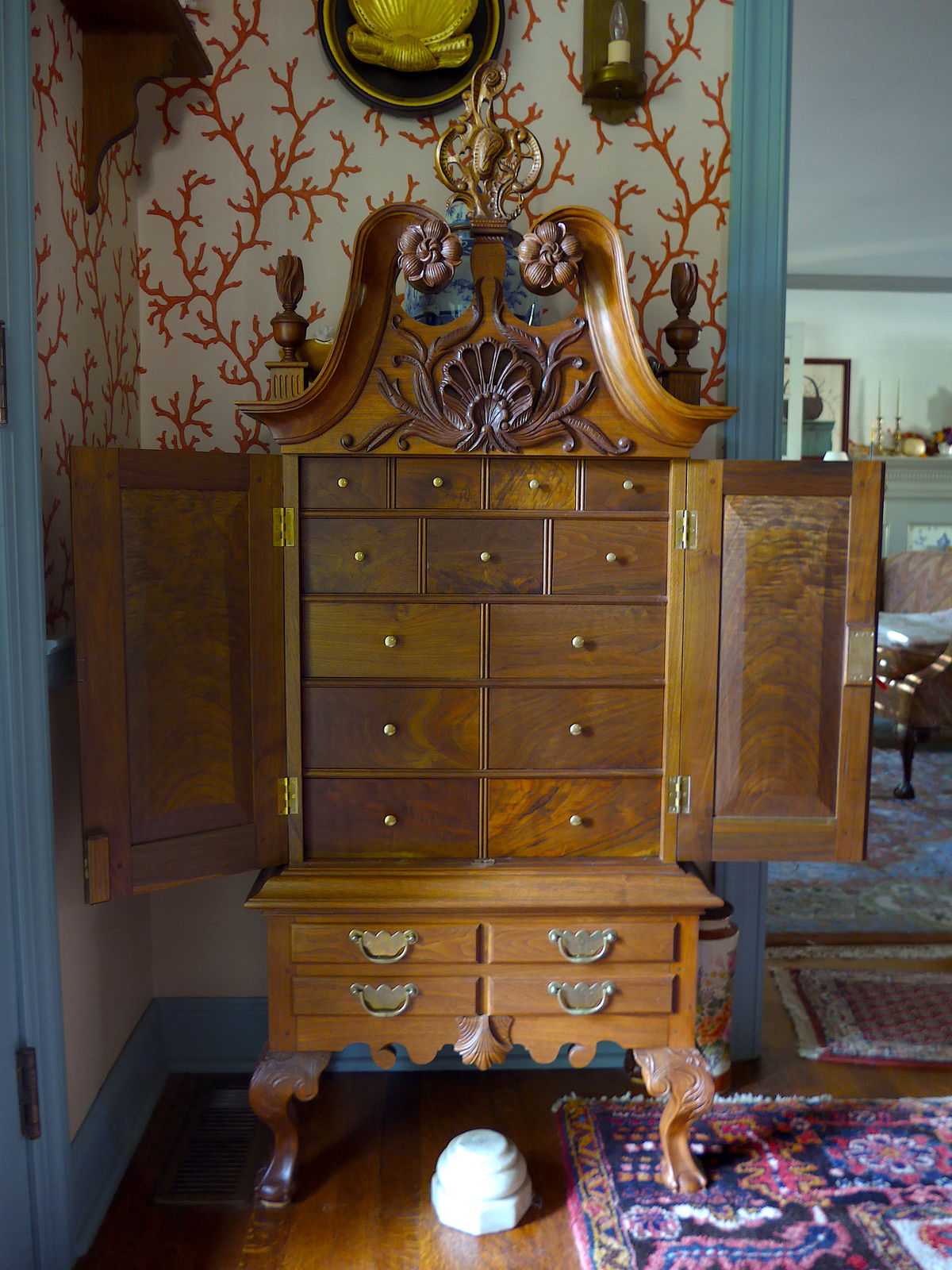

October 9, 20197 yr comment_204504 It wasn't a surprise that I found a project in the catalog "Spice Chests of Chester County". I had been looking for a challenging project and found one in the duplication of one of the spice chests. Using only photographs, I proceeded to draw up a full scale drawing of the chest. This alone was a challenge and took me many tries to get the drawing to look right in both size and proportion. Little did I know that the rosettes and finials were Victorian replacements. When "Fine Woodworking" came out with articles on Philadelphia finials and rosettes, I removed the Victorian ones and replaced them with period correct ones. The primary wood is walnut, the secondary woods poplar. The chest is a 1/2 scale of a tall chest-on-chest(tallboy) made in Philadelphia, c. 1775 and is made in two sections.. the lower and upper portion. Unfortunately, I didn't think to take photographs during the build. Report

October 10, 20197 yr Author comment_204549 2 hours ago, Cal said: Wow, that is super! How long did that project take, how long to draw up the plans and how long to build? Have you done any other piece inspired by the book? Thanks. Drawings took about 2 weeks, off and on, or 10 hours of drawing, measuring and erasing(lots). The actual build was around 4 months, again off and on, or about 100 hours. I've got two other spice chests that I've built and one relates to the Philadelphia style. I'll try to post a few photos of that one later today. The other chest was a copy of one that was built in York County, PA(according to the photo in MAD). Report
October 10, 20197 yr Author comment_204569 1 hour ago, Michael Thuman said: Frederick, what type of finish did you apply? Finish was two seal coats of shellac followed by two coats of eggshell varnish. All coats were rubbed out in between coats. Report

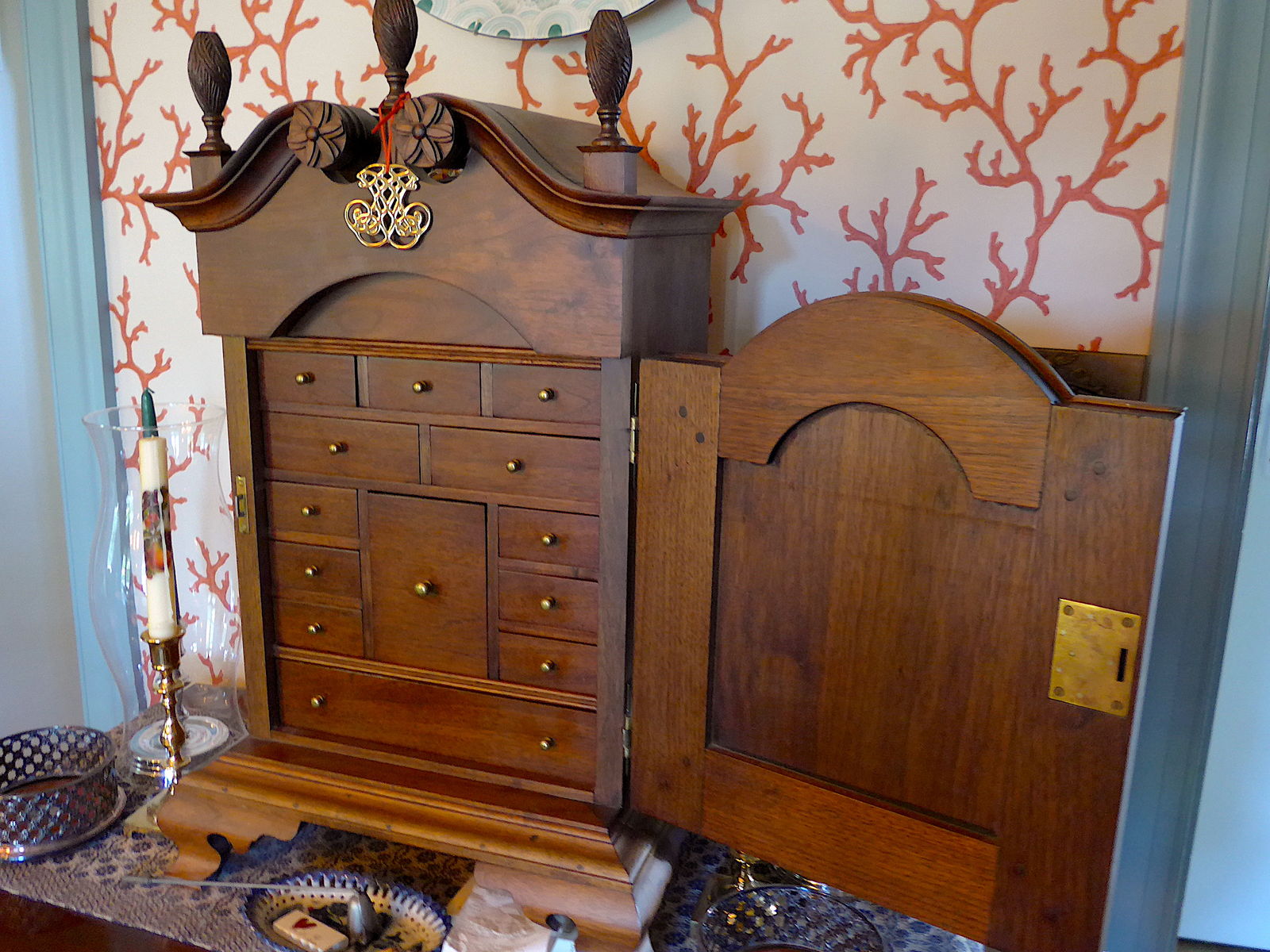

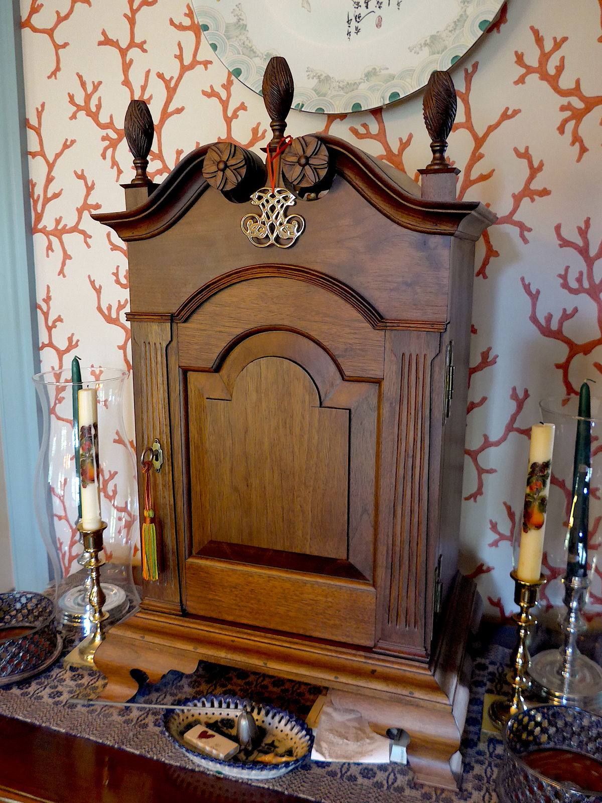

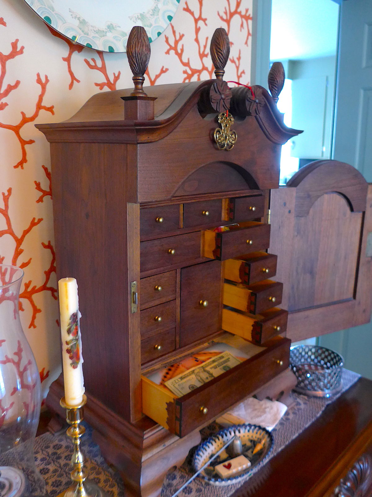

October 10, 20197 yr Author comment_204571 2 hours ago, FrederickH said: Thanks. Drawings took about 2 weeks, off and on, or 10 hours of drawing, measuring and erasing(lots). The actual build was around 4 months, again off and on, or about 100 hours. I've got two other spice chests that I've built and one relates to the Philadelphia style. I'll try to post a few photos of that one later today. The other chest was a copy of one that was built in York County, PA(according to the photo in MAD). Here are some quick photos of the other Philadelphia-style spice chest that I made. I didn't take any photos while the construction was going on. The drawer arrangement is typical for the Philadelphia type of cabinet. Walnut as the primary wood and poplar used for the secondary wood. Hardware is by Ball and Ball. Report
