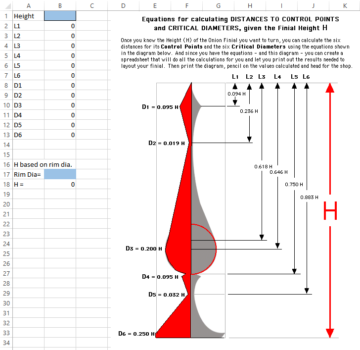

October 2, 20197 yr Popular Post comment_203667 Decided to make a few finials using Cindy Drozda's spread sheet. Lew posted it in the July 24 Wednesday post. I like those dimensions. Made for a good looking finial. I did a 3" and a 4" to see how the would turn out. Report

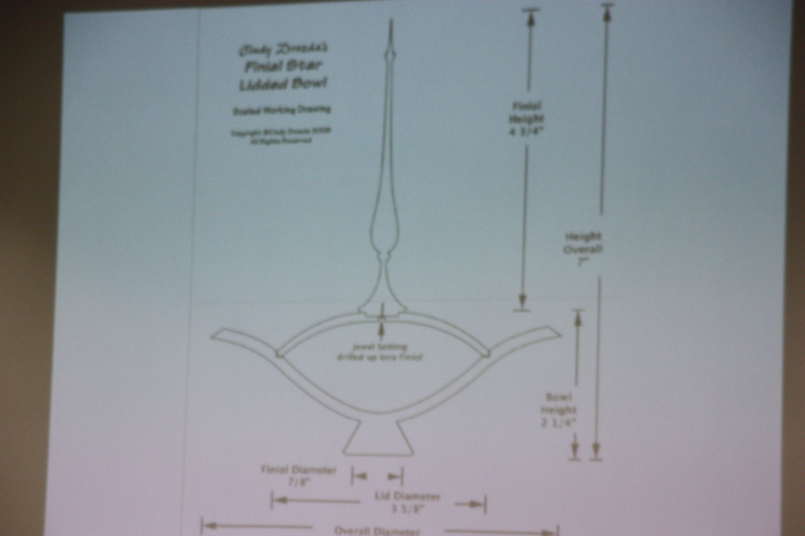

October 3, 20197 yr comment_203814 Good job Dan. Just thought y'all might be interested in the slides she does for a demo without all the fancy numbers. Report
October 3, 20197 yr comment_203817 Really nice job. Someday, I will give these a try. I am curious as to the diameter of the stem that inserts into the lid/top. And, the diameter of the .....I guess flange? Edited October 3, 20197 yr by FlGatorwood wasn't finished. Report
October 3, 20197 yr Author comment_203832 2 hours ago, FlGatorwood said: I am curious as to the diameter of the stem that inserts into the lid/top. And, the diameter of the .....I guess flange? I made the stem on the bottom 1/4" because that's easy to drill for. I also under cut the base because tops of vessels are usually curved and undercutting makes for a seamless seat. The other dimensions come from the chart supplied in the July 24th Wednesday Wisdom thread quoted above. Here it is again. It is all based on the height or finial decided upon by the turner. Report
October 3, 20197 yr comment_203846 1 hour ago, HandyDan said: It is all based on the height or finial decided upon by the turner. At rows 16, 17, 18 you can enter a rim diameter and it will calculate the "recommended height". Then enter the height in cell B1 to calculate the remaining dimensions. Sometimes I turn a vessel and make a place on the lid without thinking about the finial until later. Report
