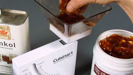

Adam Welker Posted September 20, 2019 Report Posted September 20, 2019 I use dewaxed shellac as the main finish on the majority of my projects. It’s definitely more than just a sanding sealer. Also, it’s helpful to make sure the denatured alcohol you use is at least 190 proof. The home centers here sell a brand called Kleen Stirp Green that works great. If you do go with flakes, I’d recommend visiting Shellac.net. They have a huge assortment and varieties of shellacs and the site is packed with great information on using them. Prices are the best I’ve found inside the US and the quality and freshness of the flakes is great. And just to clarify, a pound cut refers to the amount of flakes combined with a gallon of alcohol. So a 2lb. cut is 2lbs. flakes mixed with one gallon alcohol. 5lb. cut is 5 pounds flakes, 1 gallon alcohol, etc. You can of course reduce the ratios so you don’t have mix so much at once. John Morris 1 Quote
John Morris Posted September 20, 2019 Report Posted September 20, 2019 On 9/18/2019 at 8:29 PM, kmealy said: That's not exactly right, but close enough. Hey Kieth, I think I stated basically the exact same thing? Quote Common shellac recipes Dry shellac is mixed with denatured alcohol in a particular ratio called a cut, which refers to the amount of shellac in pounds dissolved in a gallon of alcohol. A 2-lb. cut of shellac is 2 lb. of shellac resin dissolved in a gallon of alcohol. A 5-lb. cut would be 5 lb. of resin dissolved in a gallon, etc. When mixing shellac from flakes or buttons, you can scale down the ratio of cut to make a suitable amount. For example, adding 2 oz. of flakes to 8 oz. of alcohol produces a half-pint of 2-lb.-cut shellac. Mixing Shellac - FineWoodworking WWW.FINEWOODWORKING.COM Shellac is a natural resin that's derived from the secretions of the Lac bug--an insect that feeds off trees indigenous to India and... Quote
