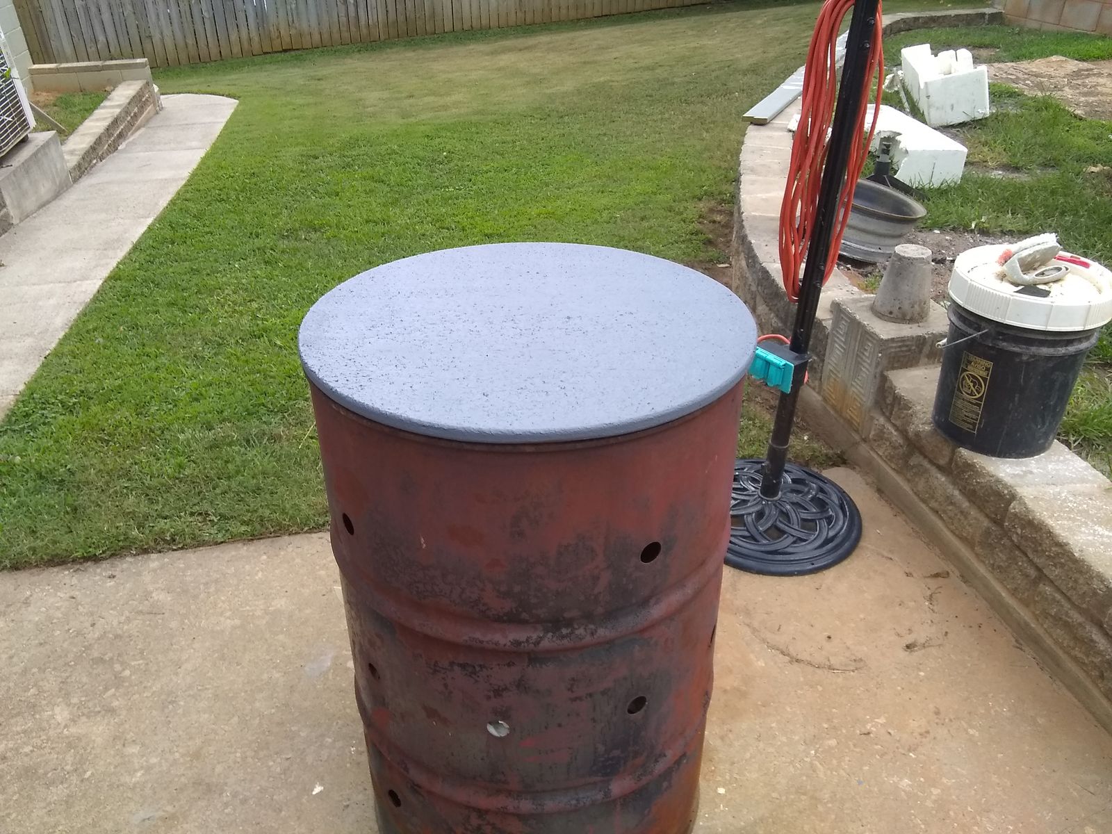

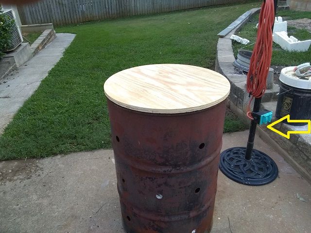

September 1, 20197 yr Popular Post comment_200324 My wife put the cover on the burn barrel awhile back. Seems the fire was not done and the wooden barrel top well, it burned... Now that I am done with the deck this can be fixed. We like the cover to keep the stuff inside from getting wet until we burn. Also the cats seem to enjoy yet another perch so hey a win win situation. Broke out my circle cutting jig for bandsaw and proceeded to cut two pieces of 3/4 plywood neighbor gave me. Two nice neat circles one undersized to fit the lip so it stays put. Rounded the edges on the router table and did some light sanding. Glued and screwed it together, used the 1/4 hole for the jig as my centering mark and done. Next up is paint. Nothing fancy just a task that needed to get done. Sure was nice to have the jig ready to go. Report

September 1, 20197 yr Popular Post comment_200359 5 hours ago, Artie said: What? No electrical work on this one? Oh it's there at the ready. Report

September 4, 20197 yr Author comment_200576 Project now complete, another one checked of the list. Don't even ask how many more to go. At least 3 lifetimes. 2 coats of Deck Over, gives a semi rough surface like used on the deck. Report
