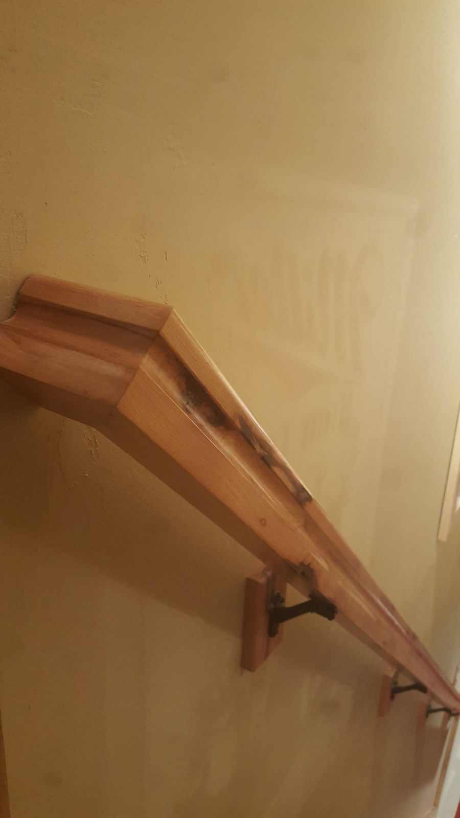

 My wife has bad knees and asked me to install bannisters (handrails) going down the stairs to her washroom in the basement. She is a short person and I'd like to install them at the best height for her. I read where the standard height is 34 inches. However when I make canes, I measure the individual for proper cane height. Does anyone have any advice before I do this job? Do they always go on the right side?
I got lucky and found the old handrails in a basement storage area. Then located the old covered over holes where it used to be. If there is a better place for them, I'd like to know.

As Cal said there is code, and then what is practical. If it's not being inspected do what is comfortable for your wife. We use rosettes screwed to the studs, bracket then gets screwed to the rosette. I highly suggest putting returns on the ends, so she or you don't hook your shirt or clothes basket on the ends, (that is code where I live) and a good one.

please consider placing support at more frequent intervals and using only solid brass instead of the cheaper pot metal.
Good idea, you really want this to provide solid support to prevent failure in case the rail really takes a load from someone falling.
