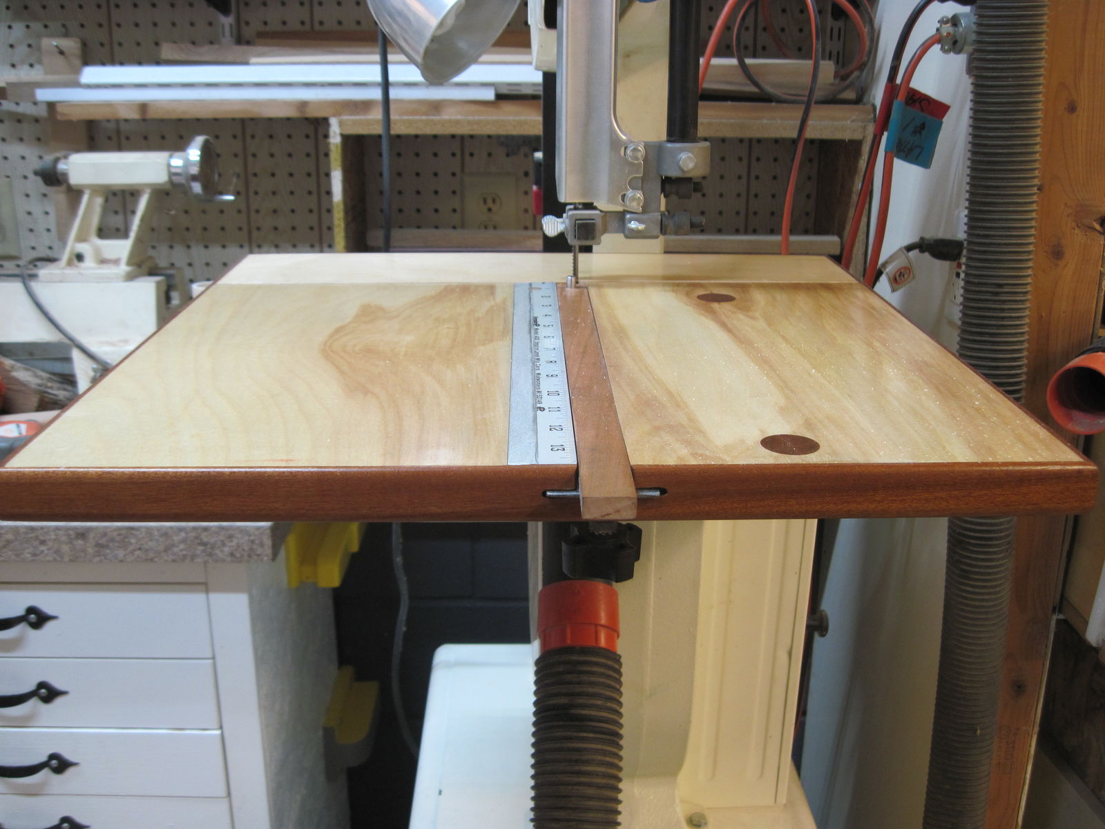

July 16, 20197 yr comment_196100 Corian at 1/2 thick can be had fairly inexpensively. For this you mentioned 12-18 inches in diameter. I have some 1/2 thick, in a white that would work for this project. Also have a circle cutting jig for the bandsaw and a blade that would make this cut. It can be done, have done before. NOT with stone, but I have done plenty of wooden and Corian circles and odd shapes. If you want a square of that size in Corian PM me, glad to send it to you. If you want me to cut the circle, no problem, already have jig. Used a couple of days ago. Do note that the bottom will have a 1/4 hole used to find center for jig. Circle cutting jig for a Bandsaw, Woodbutcher Special Edition Report
