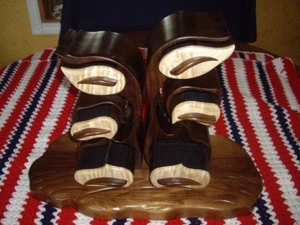

June 23, 20197 yr comment_194204 Gator, I did that one, too. And the Lotus Flower. Both, on the little Shopsmith band saw. Here's a not great picture of the lotus. Walnut and curly maple. Sanding it was challenging, to say the least. Report

June 23, 20197 yr comment_194243 6 hours ago, Cal said: Steve, some great work there. Please post up more of your work here on TPW! Cal, you know what assuming does and that is what I did. There is a page 2 so here is the link to the finished product. http://www.shopsmith.com/ss_forum/general-woodworking-f5/dogwood-bandsaw-box--t22041-s10.html I just noticed the "view" count is rather high. As long as other learn how to do these things for themselves. Gene, that is a fabulous piece of work. I did one with all cedar that was grown in the front yard of the wife and her family. And, the bottom is a piece of pecan. The pecan had the poop where the worms had been through. Since wife's sister's husband worked for the state EPA and loved discussing poop at every meal, I used it especially for him. They love it. I tried to find a picture, but it's not here. Don't know how I lost that. I like the color coordination of yours. And, yes, the Shopsmith bandsaw is a great tool. Gerald, I almost feed my saws slow. I try so hard to stay just to the outside of my line and my hands shake some, but I am more concerned with accuracy than anything else. I have considered the Carter bearings, but I get good results with cool blocks. As long as I can hold it steady, I'll be happy. It is aggravating to get a blade hung up in a log. Been there, done that. Also, just picking at you. Report
