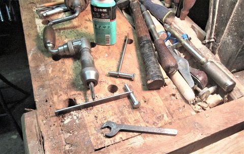

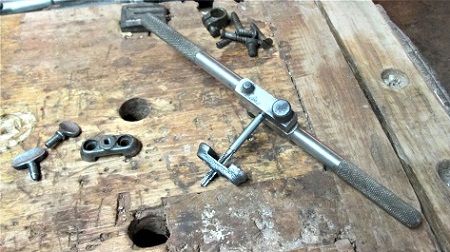

June 14, 20197 yr comment_193485 Hmmm...we have ways... From a (too small) "T" wrench..to.. A bit bigger...and then... I use a cordless drill... Report

June 16, 20197 yr comment_193636 This spring-loaded guide fits into the center machined in the top of a tap wrench, follows the tap down as it cuts and keeps it straight Spring-Loaded Tap Guide - with the chuck centered over the hole and the guide clamped in the chuck, set the tap into the hole and lower the chuck until the point is compressed. As you turn the tap, the point keeps the tap aligned with the hole. Or, you could go with something like this V-Tap Guide Report
