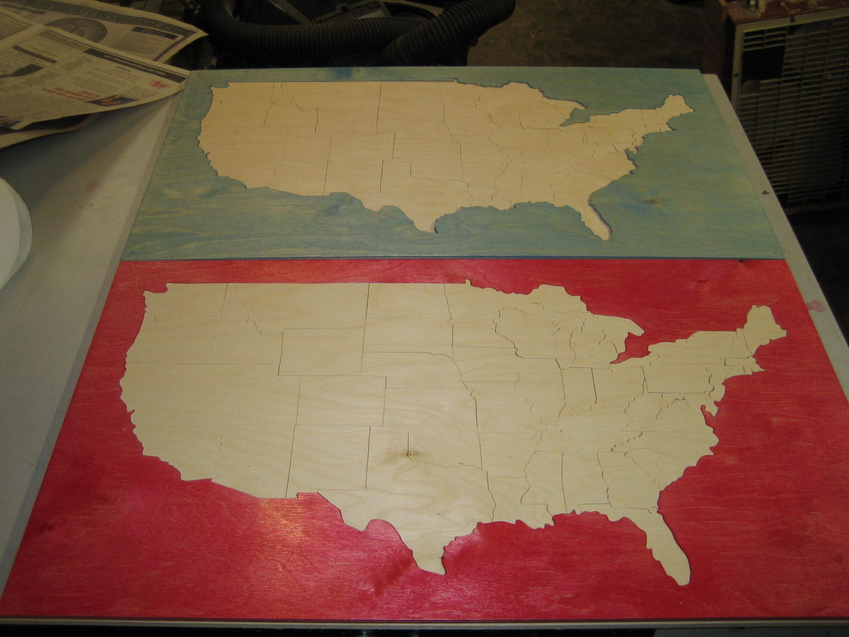

Went to the big town this morning, got home about noon. Why not make more state puzzles. Only this time I printed out one pattern and made two puzzles...I nailed 2 1/4" bb plywoods together and cut them out in the same amount of time it takes to cut one out...I did use Scotch brand clear packing tape on the wood before I sprayed it with stickum. For the guys who uses Duck brand tape and you are getting all kinds of sticky stuff left on the wood that someone has to clean off then try Scotch Brand. A little more money but the clear tape is the reason I use it so I don't have to work to get the wood back clean again so I can continue with other things..There are a few different types of Scotch brand and the thinnest is not good for it will tear up while removing it off the wood...
  It is a good idea to remove the pattern pieces as soon as you get the sawing finished for the longer you wait the harder it is to remove. I used about 15 small brads in places around the pattern where the saw blade wouldn't hit to keep the 2 pieces of wood together while I cut out the states and I do pre drill some small holes smaller than the size of brads I used so it would be easier to pull the wood apart after I finished sawing.. The brads were .40 so I use a .37 drill bit for the pilot holes.
   I make sure all the pieces from the top board stays together and likewise the bottom board pieces stays together..  This is easiest enough to do for the top board will have the pattern attached..
  Cutting out two puzzles on the scroll saw is the same amount of time as cutting one puzzle...

 I do my own thing when it comes to coloring my projects... Just what ever hits me at the time..and since these state maps are for younger kids, I want them to be interested enough to impress the older crowd so I try lots of different things to catch their eyes.IMG_1991.JPG.9e36b60510bb620ded6b15e5bb8d5bec.JPG
These are larger than that last map I finished making by 1 1/4" wider....I had forgotten what size I put in on Rapid Resizer before I hit print.
These are not to impress the Democrats or the Republicans but hopefully the young crowd will like them.
There's one guy who might complain that you are 7 states short. Come to think of it, that guy was probably born in one of those missing seven. :ph34r:

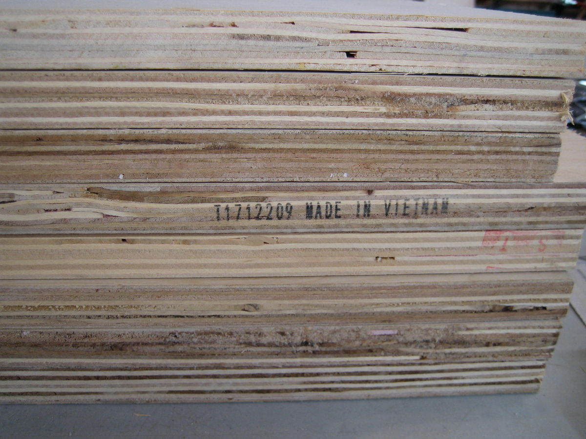

  I never use anything but Baltic Birch plywood . Only one place in Abilene, Tx carries BB and only in 1/2 and 3/8". I do use 1/8" and 1/4" a lot and have to order it from Woodworkers Source in Arizona and I have my choice of cut up sizes they have to cut up those 5 by 5' pieces before they can ship them so I have them cut all the pieces in to 20 x 30" pieces.  Freight is terrible so I wait till I can afford a train load at a time. The next shipment will be in Nov. 2028.
  My daughter lives in Austin, tx and she found a cabinet shop who had lots of cut offs for a bargain. She called me and asked if I could use pieces that are about 15 x 30" ,, lots of them and she said she ask if they were Baltic Birch and the owner said that is all they use.....IMG_1490.JPG.acb7f0d57dcca644dd52dad12fc9c15c.JPG
I hate to tell my daughter she was another victim.
Good Lord. That is pure crap. That guy needs a world map! Vietnam is a long ways from the Baltic.
