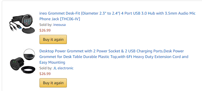

Mind telling me where you got the Power/USB Port assemblies?

I purchased the electronics from Amazon.  Danl

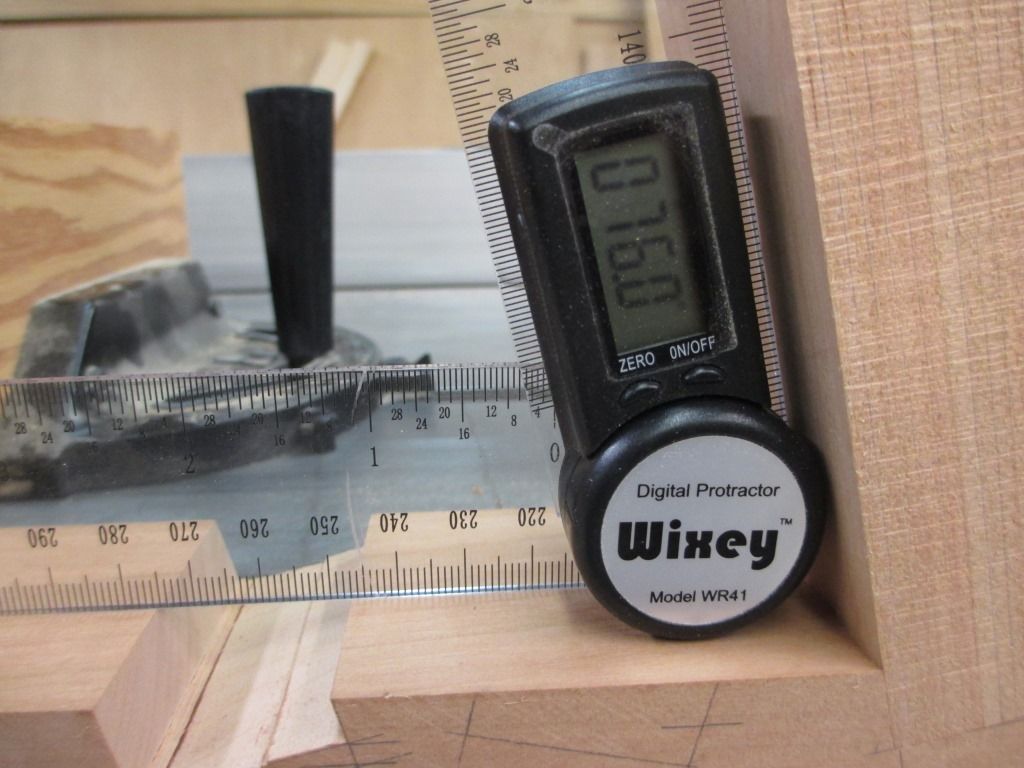

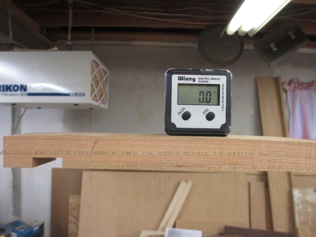

I found an article which gave a formula using number of plies and project radius to determine form radius.  I wanted a 9” project radius, so I was to use a 7 7/8” form radius.  When the lamination was pulled of the form after ~ 24 hr., I had zero spring back.  I had 10 plies, each 0.095 thick.  When I pulled of the clamps and caul, I noticed a crack in the outer ply.  I believe this was created perhaps due to by a combination of the wood grain not being straight grain, the shifting of the plies during the clamp up, and I continued to apply additional pressure during the curing (I am not certain).  I do know that as time goes by, the glue minutely moves and some of the clamps result in having less pressure.  I had extra plies available so I glued another ply to the assembly.  After I pulled the glue-up from the form and let it set for the weekend, I had a slight enclosed angle.
Having a tighter radius was better than a larger radius.  The final results were excellent (beginner’s luck).  The pics reflect 76 deg. and zero degree, exactly what the form was built to.
