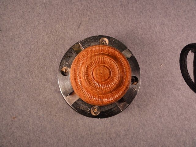

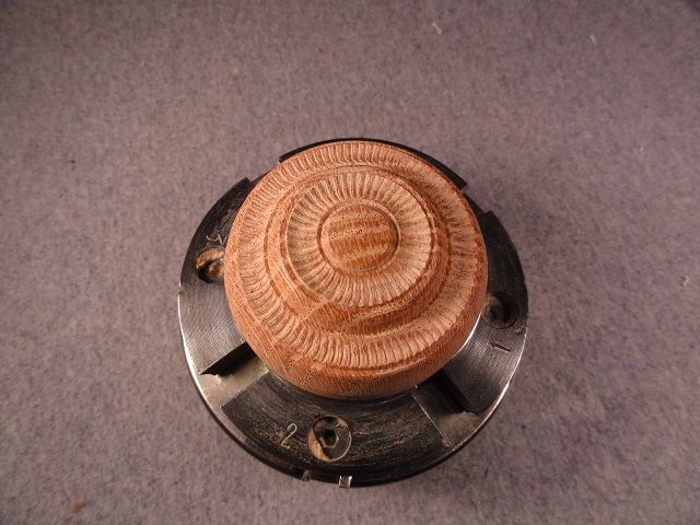

I built my version of the Henry Taylor "Decorating Elf" and it works nicely.

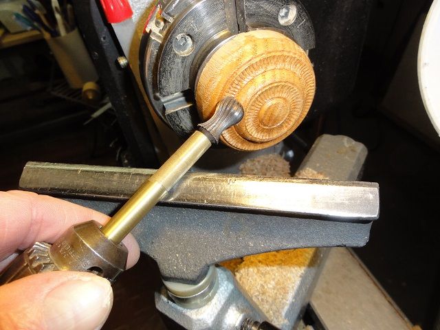

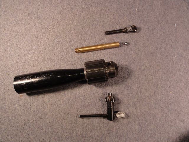

I took a piece of 3/8" brass rod and drilled a 1/4" hole 1.5" deep and dropped a 1/4" ball bearing in and called it done.  I chucked it into my drill handle that I use to drill center holes in turnings sometimes.  I made the drill handle from a Black & Decker drill that went bad.  Bolted the stabilizing handle to the chuck.  Most chuck threads are 3/8" fine.  It certainly won't take up much room.  Here are some practice pictures.

I made the drill handle from a Black & Decker drill that went bad.  Bolted the stabilizing handle to the chuck.  Most chuck threads are 3/8" fine so I just bolted the handle to the chuck.  I use it to center drill on the lathe when it doesn't require the precision of the tail stock mounted drill chuck say for drilling and hollowing an ornament to take out some weight.  It filled the need for a handle for this quite nicely.

A question my apprentice asked that maybe someone else would want to know.
How to use it?
How to use it?
Craft supply sells the commercial version. They have a video on their website showing it in use.

3 hours ago, Gerald said:
I have a drill handle almost just like that except no fancy black paint job jut the pecan.
If you look real close at the second picture it says Black & Decker on the handle.  It is a reused plastic stabilizing handle from an old drill.
