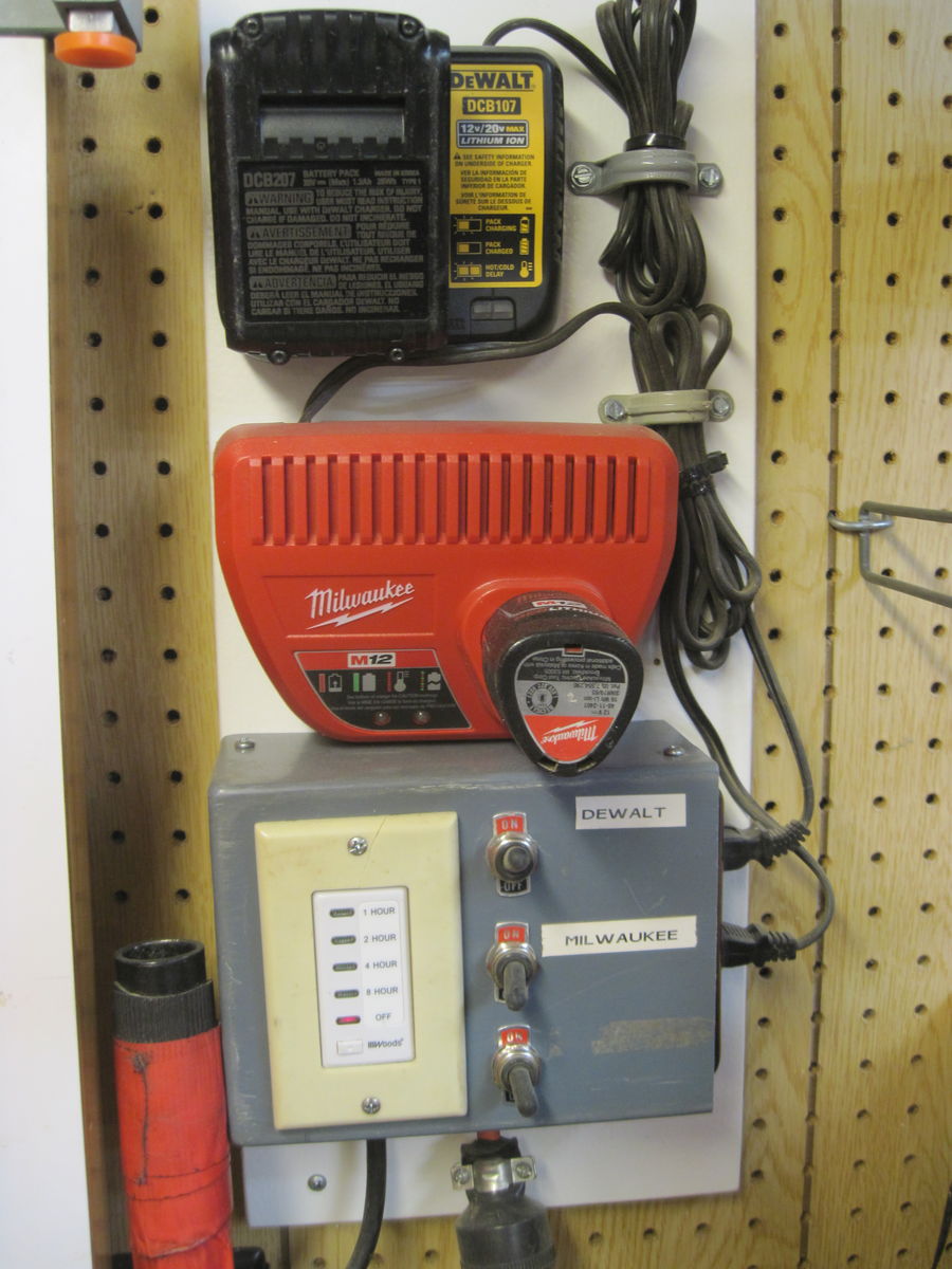

One of the problems with modern chargers is they want to top off charge.  Great idea but that counts as a charge in the lifetime expectancy.  To eliminate this I made a charging center with a timer and then switches for each charger.  Now the power is on to the charger for only the time allowed.  The charger cannot top off with a short charge taking away one of those lifetime charges.
Here is what I use:
This covers the Dewalt 20vt and Milwaukee 12 volt with one extra plug for something else.
This is for the Streamlight Flashlight and one extra port as well:
