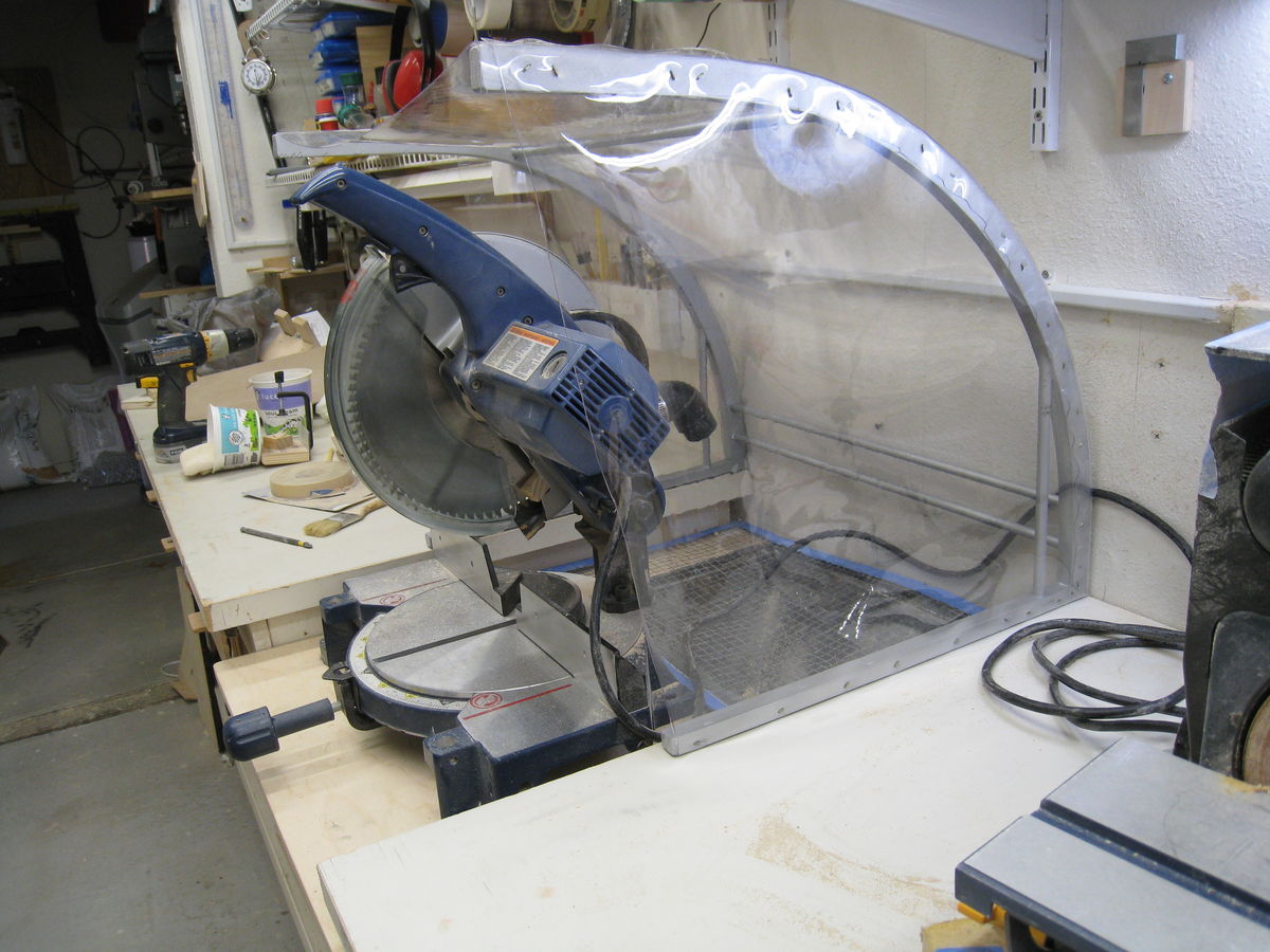

March 13, 20197 yr comment_182282 This is my Mk-II shroud app. Note the hole in the bench behind the MS: that's the 16x20 scoop, 4" DC connection, down (yeah, grav always wins). MS' are known for their difficulty in dust capture. Note I don't even try to use the on-tool DC port. I like the clear plastic because it allows a lot of light in. Capture is about 90% gross particulate. Fine particulate is about 99.9%. Note screen over back bench opening (blue edge tape frames the screen): yeah, without that I consistently drop things into the hole. Report

March 13, 20197 yr comment_182309 5 hours ago, PeteM said: yeah, without that I consistently drop things into the hole. You haven't found my pencils in there by chance have you Pete? Not sure, but there may be a drill bit set and tape measure too. BTW...nice set-up...sounds like it gets most of it. Report

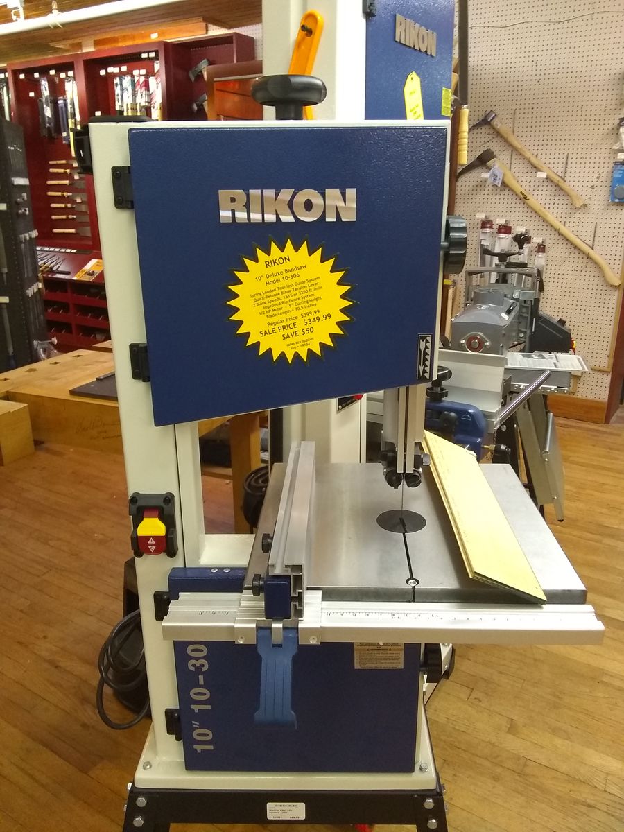

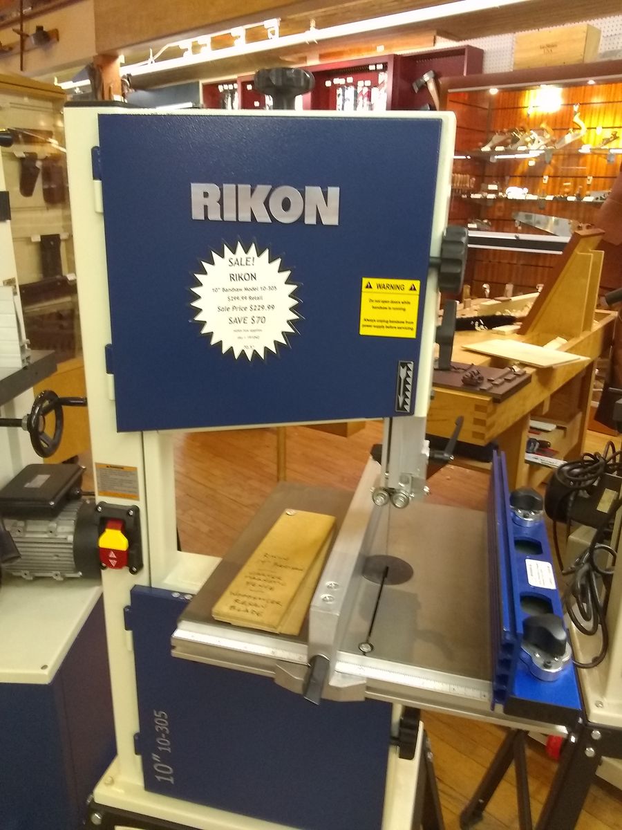

March 13, 20197 yr comment_182311 2 hours ago, CharlieL said: I noticed that subject has been idle for over a week. I was looking at the Rikon's also. Highland Woodworking in Atlanta has both in stock. The older version 10-305 is $229 plus tax, the newer version 10-306 is $349 plus tax. This is the 10-305 This is the 10-306 Report
March 13, 20197 yr comment_182338 If your reason to get a different saw is to upgrade, then you want the 10-306. Report
