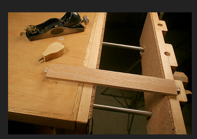

Like this?
Herb

2 hours ago, Dadio said:
Like this?
Herb
Good alt.  I was thinking drilling the chop itself, small holes, brass dowels.  This would lessen the tendency of the wooden jaw face to tilt under pressure (and--heh--because I just used dbl sided tape to fix my wooden faces to the metal.  Never discount laziness!).
