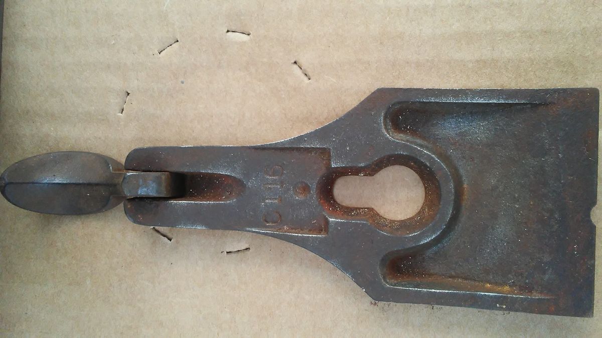

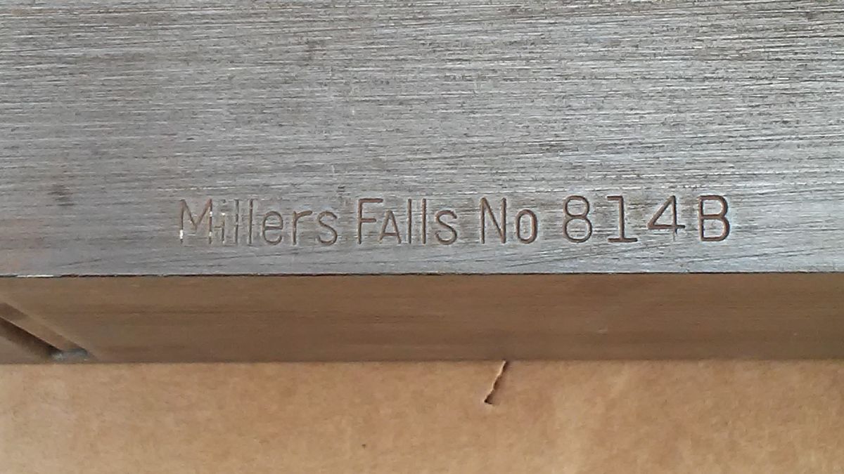

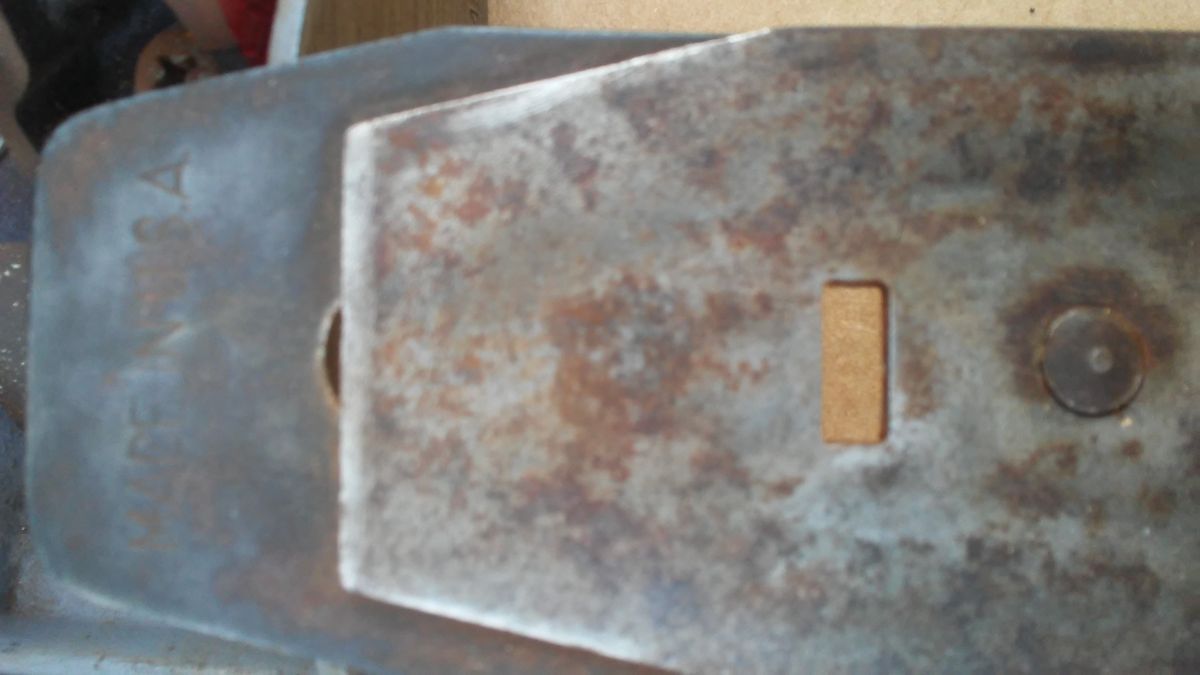

Millers-Falls #5~ 814B Smoothing Plane. ca. 1966-1974 as picked...$15 + 7% State of Indiana "buyer tax." The Phillips screw heads and painted tote & knob probably
make it around 1967-68??? The lever cap may have initially been painted black??? The decal is not like the Mohawk-Shelburne so may have been a hardware retailer label?
It is cast with Made in USA behind the frog which indicates the plane body may have been an early '66 or previous carry over 814 then the "B" added????
From what I've learned the 814B first appeared ~1966 and was discontinued ~1974 being replaced by 9814...This plane has variations of an earlier version 814 but also
has features consistent with the V(value) Line or Economy homeowner version but inconsistent in that regard with the red frog and permanent stamp of model number.

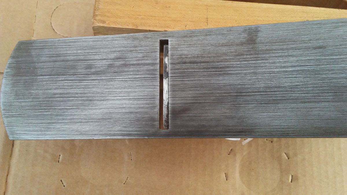

Lack of polishing on the sole & sides are consistent with the '67-68 & later time frame rather a

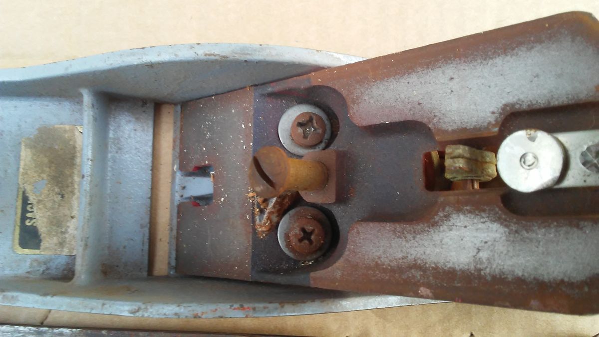

Phillips head screws for the frog also indicate no earlier than 1966 as does the gray painted body and red frog.
Only other marking on the plane is the C116 cast into the backside of the lever cap. No evidence of black paint bleeding over from from though??? The cap iron is
more consistent with the value line but they were discontinued prior to the "B" series. It does resemble somewhat the 9814 which was produced after 1974.

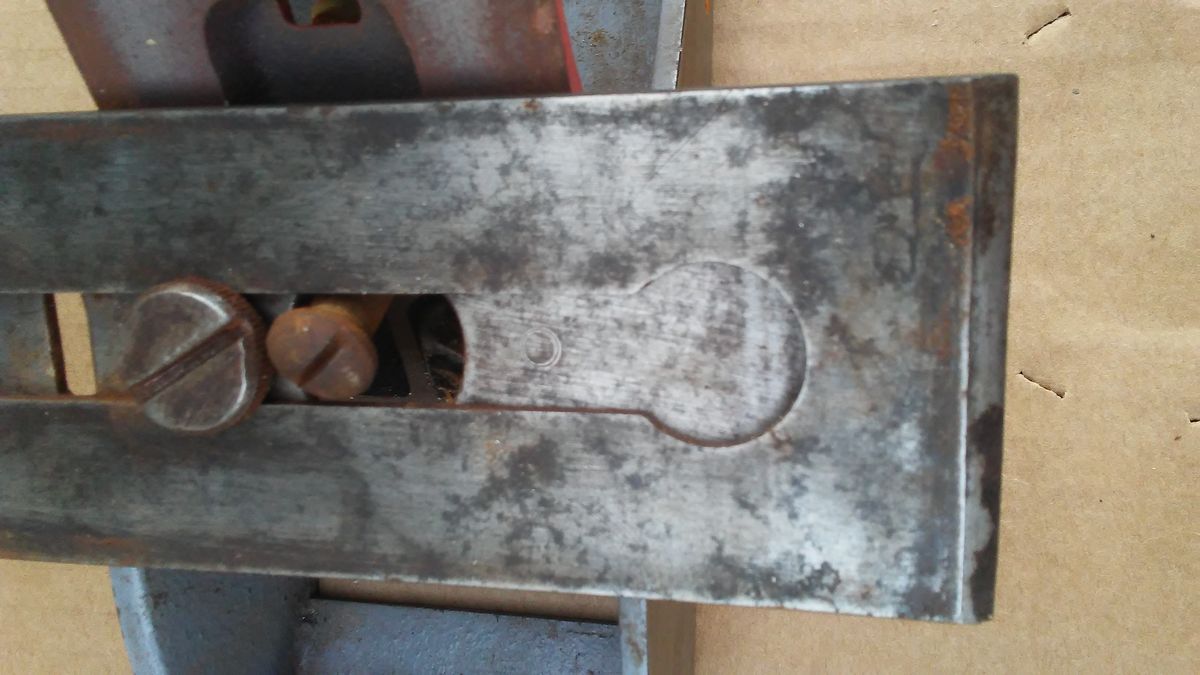

Iron is stamped with Made in the USA, but no tri-angle. Some had no markings on the iron, others only the Millers-Falls trademark tri-angle but without any date.
Chip-breaker is consistent with an 814B of the '66-'74 era.  Needs cleaned but make full contact on the iron and not bent.
Iron has been re-sharpened; will need some work to get the proper angle and square to edge again. Good test for my new M-Power, Fasttrack sharpening system.
It does look like the lever cap has been painted black??? Red frog and non-recessed, non-plated steel adjustment knob is also consistent with a later Type 5, 814(B)
The tote (& knob) are hardwood, but painted black.
In all honesty, this plane appears to be some "hybrid" from M-F...M-F was noted for using all parts especially as models changed. It has parts that might be from the end of the run
of the Value line in the early 1960's, later Type 5 814B parts as well as early type 5 parts. It truly appears someone at M-F cleaned out parts bins until they were used up, then began
with new runs.
If warm weather ever returns where my tongue doesn't stick to the plane body, this one will be fun making into a user. The frog should be robust enough to support a
thicker iron & chip breaker.
Thanks for looking...
