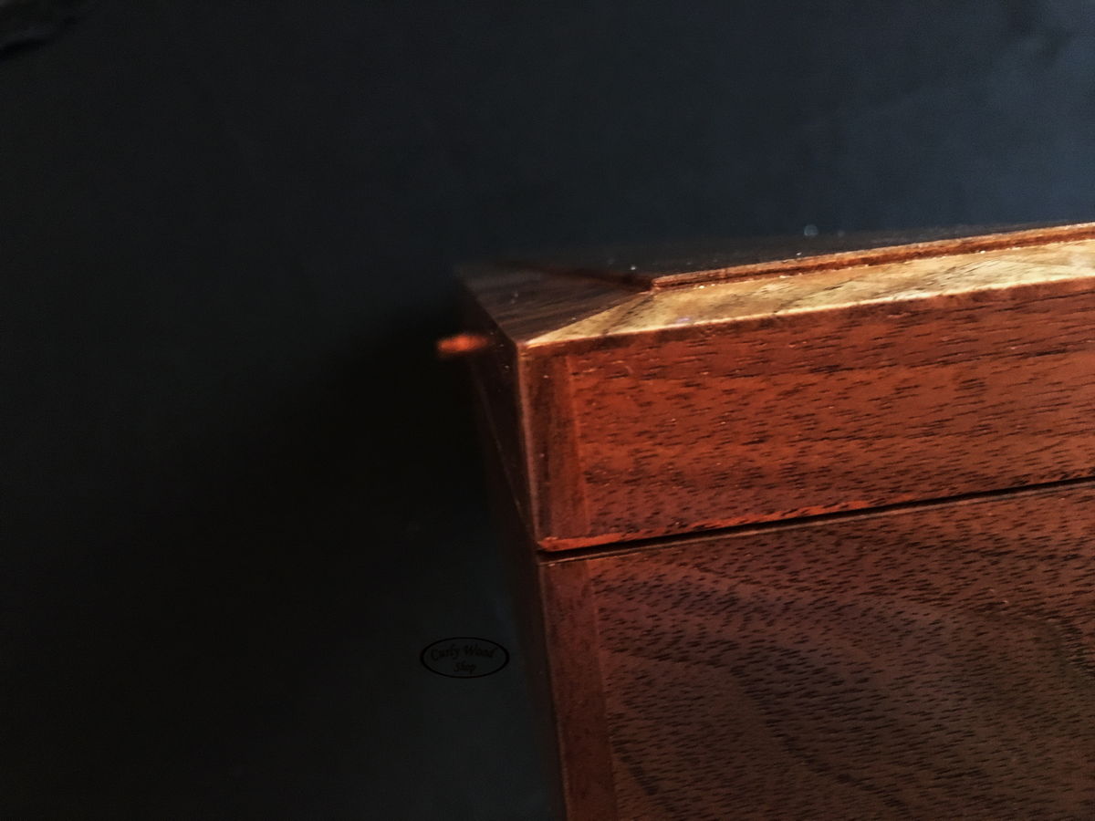

February 13, 20197 yr Popular Post comment_178341 A friend builds some very nice custom knives and we've been talking about a collaboration on Etsy, for him to build the knife and me to build a box. He didn't have a knife ready but I built a box anyway. And I built a knife... The box is Walnut with Figured Walnut accents and Red Palm handles, finished in Nitrocellulose lacquer. The knife is Curly Maple, Red Palm, and Figured Walnut, finished is French polish Shellac. Enjoy! David Report

February 14, 20197 yr Author Popular Post comment_178391 It just occurred to me as I looked at the photos that I didn't mention, nor does it show, but the figured Walnut border on the lid is angled 7.5°. I cut those strips about 1/16" thick and then had to miter them at the corners. With very thin veneer that's pretty quick and easy but with pieces even 1/16" thick that has to be a compound angle. Came out ok, though. Also, I used rare earth magnets on either side of the Red Palm to keep the lid closed. David Report
February 14, 20197 yr comment_178477 15 hours ago, difalkner said: With very thin veneer that's pretty quick and easy but with pieces even 1/16" thick that has to be a compound angle. Came out ok, though. Also, I used rare earth magnets on either side of the Red Palm to keep the lid closed. Now that's extra attention to detail and sets the box off from all the others. Mighty fine work...mighty fine. Report
