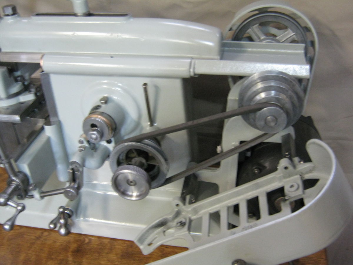

Popular Post GerryinBelleRiver Posted February 5, 2019 Popular Post Report Posted February 5, 2019 Just returned from a six hour car ride the purpose of which was to pick up this Ammco 7" shaper. It belonged to the sellers Granfather who bought it new an only used it in his home shop. We had to drag it up a flight of stairs. The sellers father who was there said he remembers carrying it down the stairs as a teenager. The machine is pretty much plug and play. The electrical needs to be redone and it needs a good clean. There is a problem with the auto advance for the table which I understand is a common problem that is fairly easy to fix. The seller made me aware of this when we first talked so this came as no surprise. All in all I'm a happy camper. P.S. If anyone has fixed the auto feed on one of these I would appreciate your insights Grandpadave52, Cal, p_toad and 2 others 5 Quote

GerryinBelleRiver Posted April 10, 2019 Author Report Posted April 10, 2019 The shaper is now pretty much ready to make some chips. I need to get a nice period lamp. I made a stand that really is a representation of the original that was available from Delta as an option I am considering making a change to how the vise is mounted. As it was not an original it had to be adapted to fit the table. The previous owner made a plate the bolted to the table. Although usable in it's present form it is almost 3/4" thick and eats up a lot of height adjustment available for this small shaper. There is room to drill and tap a couple of holes in the table itself to mount the vise. As I doubt I will ever find an original vise I think I will go ahead and make this modification. Now, to grind some tools and get busy making chips Artie, Gunny, p_toad and 1 other 4 Quote

Kevin Beitz Posted October 2, 2019 Report Posted October 2, 2019 (edited) Looks like the wrong bit holder. They are to have neg. rake. That one was for a lathe. Edited October 2, 2019 by Kevin Beitz Quote
