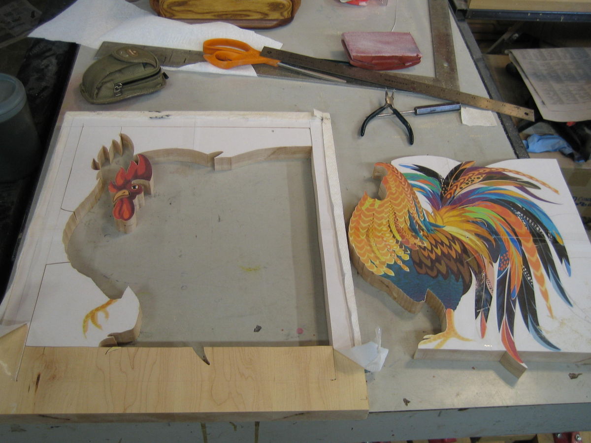

 First thing I did was to cut him out of a frame of sorts. Now to carve him up like a turkey for Halloween.
Wife did have to hold one end of the pattern so we could lower it on the the stickum...If it is straight enough I can make a decent frame around the outside so I can have something to place all the pieces while I groom them... If you don't keep the blade straight up and down while cutting the pieces you are in big trouble trying to get some of those pieces out .

 I did manage to get this two legged thing all cut up in my nice warm shop but the cold weather between house and shop is almost impossible...IMG_1649.JPG.42426c11c6389d6860961f67837174fc.JPG

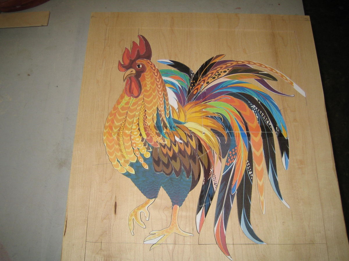

I peeled off everything but his clothes cause I sure need to study his unusually strange colors on each of his feathers..
 Dave I never broke a blade on the whole picture.. I did use an Olson #5 precision ground reverse tooth  blade for the four straight lines then switched to the # 5 flying Dutchman blade for the interior cutting..
Lots of pieces and will be hard to remember where every thing goes as the glue is setting up after all the hard work is done.

On another note, my wife just saw the picture above and said "oh, that's cute." She'll be following along now too.
My wife saw a rooster hanging in some rich ladies house years ago and has remembered and wanted one ever since...Have no idea why she was in a rich ladies house. Now when she saw me with this picture she said only make one just for me and no more so I can have one of a kind made of wood. She might should have waited till she sees it in its completed state.....then hopefully she will say the same but who knows.... Them are some strange feathers to try and make...
