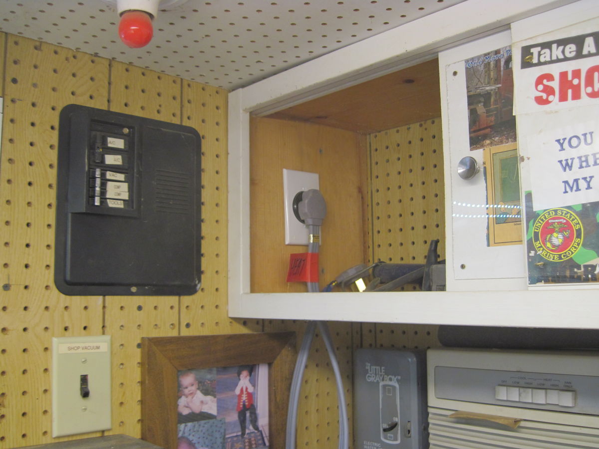

So far I am out oh, $20 for a drier outlet I did not have in my stash.  I get home and look and I will need to replace an outlet and about 18 inches of wire to it.  Thankfully the Breaker box is that close to where the heater will be placed.  Okay I knew that but in the store I am thinking this is not that big of a deal.:ChinScratch:
Now comes the proverbial monkey wrench.  Need to take down a upper cabinet, remove it, maybe just cut in half and put that much back.  Not exactly easy, but hey I need the airspace behind the heater.  THEN I will need to remove some recent DC plumbing to gain access to the wall where the breaker box and outlet will be.

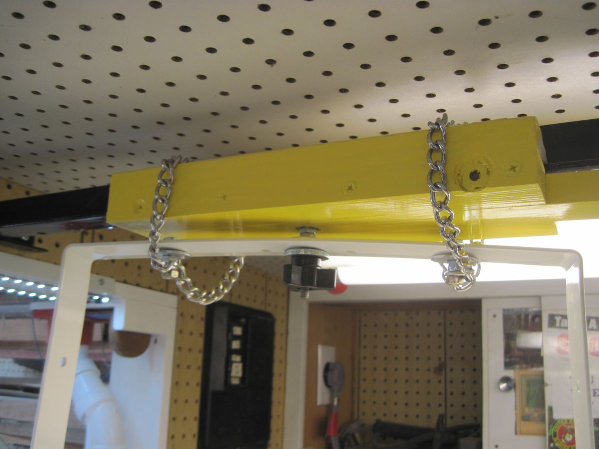

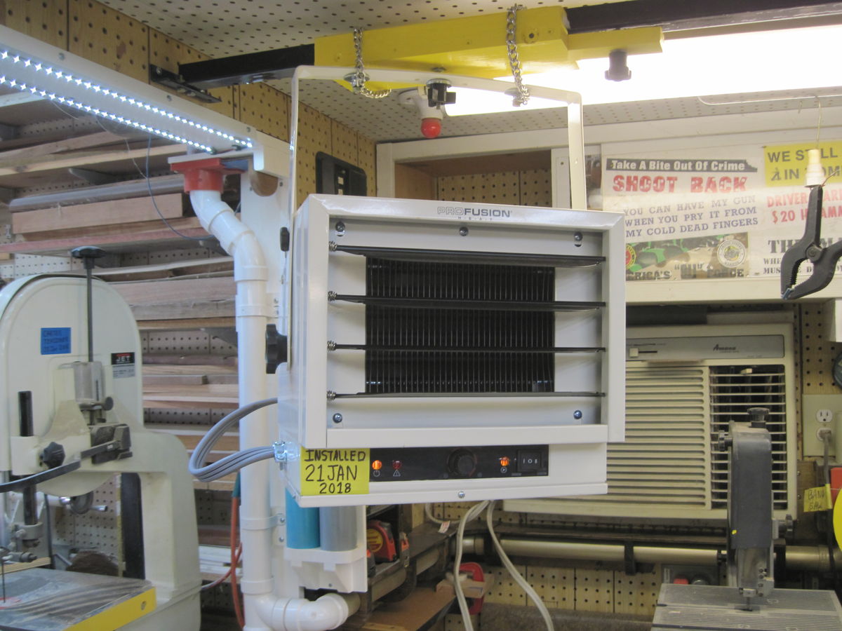

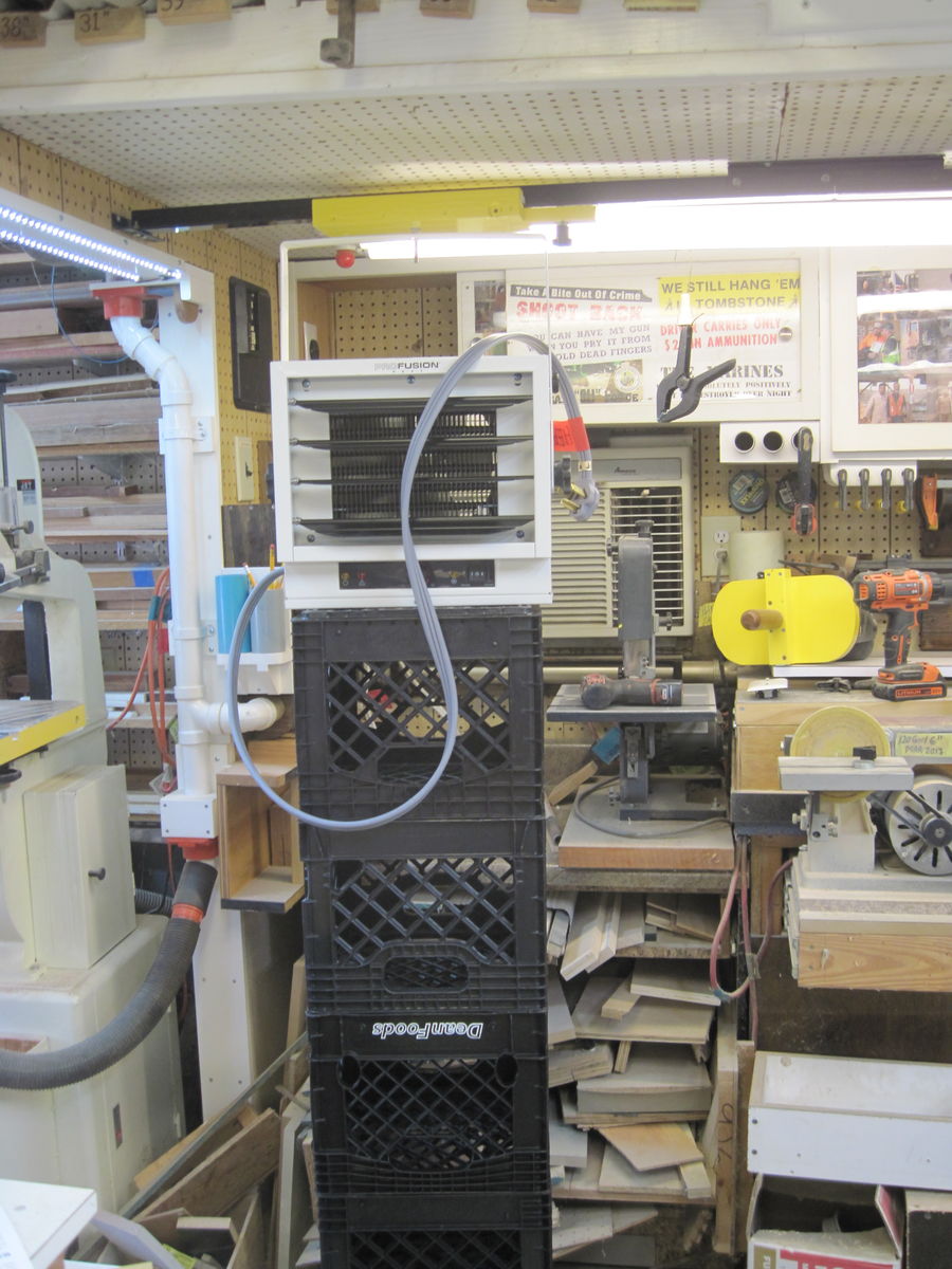

Heater installed.  I used the same mount for the heater as I have for my fan I use in summer.  Working alone I had to get creative with how to hold it in position while I installed the knob, minor issue easily overcome.  Special thanks to the QT guy that gave me the milk crates.  To insure no issues I installed two safety chains on each side that wrap over the T bar.  By using the same track I am still able to move the heater side to side when needed to access behind it if needed.  Did have to upgrade my electrical plug to 30 amps, which also meant changing out the plug on the electric hot water heater timer I use for the A/C in summer.  Granted I rarely use it but still nice to have.  Walls are insulated but the floor, well concrete will just have to stay. All in all it heats the shop from the cool 45F this morning to 80F after I left it running for 1 1/2 hours while I ran errands.  So for an hours work it should be quite sufficient to keep comfortably at 60F.
Now back to the shop to work, nice and comfy.
