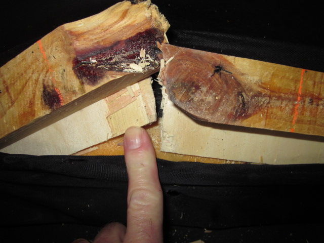

January 10, 20197 yr Popular Post comment_173356 I had a call today where the recliner had "a loose spring or broken part or something." Some Chinese idiot decided this piece of wood with a 1.5" diameter knot in it would make the perfect piece to put in the front of a seat where the springs would pull on it and the occupant would sit on it. What could possibly go wrong? Report

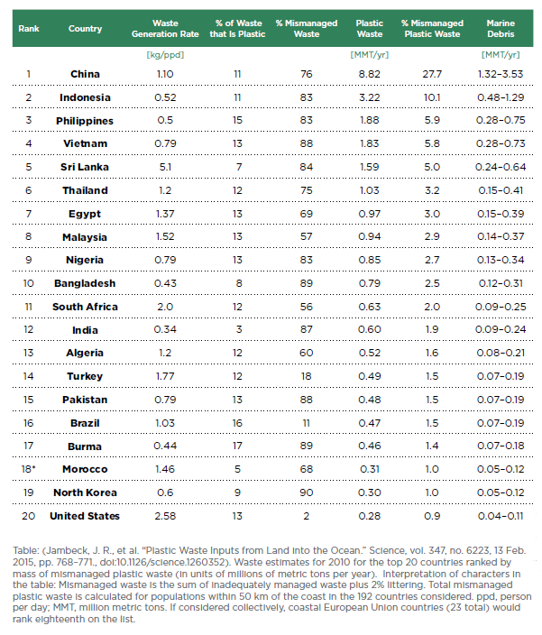

January 11, 20197 yr comment_173608 I think China is going to fish the plastic out of their rivers as needed. https://www.earthday.org/2018/04/06/top-20-countries-ranked-by-mass-of-mismanaged-plastic-waste/ Report

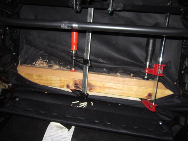

January 11, 20197 yr comment_173624 All let's focus on the wood. I see the repair we done successfully and properly by laminating good wood over the broken knot which was glued back together. As al alternate I would have cut out the know scabbed in good wood glued it then added the other peice. Let's see if the repair lasts. Report
January 11, 20197 yr Author Popular Post comment_173633 1 hour ago, Michael Thuman said: All let's focus on the wood. I see the repair we done successfully and properly by laminating good wood over the broken knot which was glued back together. As al alternate I would have cut out the know scabbed in good wood glued it then added the other peice. Let's see if the repair lasts. Yes, I'm hoping it holds too. Additional issues were working on site, fixed-price repair job, and all the springs were attached to the top of the piece. meaning they'd need to be undone and reattached via new spring clips. Nice piece of red oak, glued and attached with 8 2.25" screws Report
January 11, 20197 yr comment_173637 Great job! 56 minutes ago, kmealy said: Yes, I'm hoping it holds too. Additional issues were working on site, fixed-price repair job, and all the springs were attached to the top of the piece. meaning they'd need to be undone and reattached via new spring clips. Nice piece of red oak, glued and attached with 8 2.25" screws Report
January 13, 20197 yr comment_173924 On 1/11/2019 at 1:45 PM, kmealy said: Nice piece of red oak, glued and attached with 8 2.25" screws See that's how it is done, glue it and screw it, and use plenty of screws!!! Report
