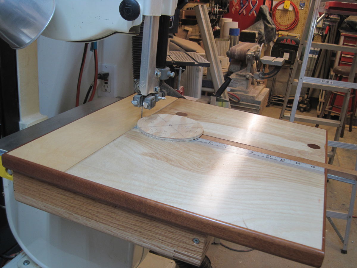

Gunny Posted January 2, 2019 Report Posted January 2, 2019 FWIW I use a circle cutting jig on the bandsaw then take to the lathe. While the circle is not perfect it is much closer than turning the square, especially on larger stuff. FlGatorwood and Cal 2 Quote

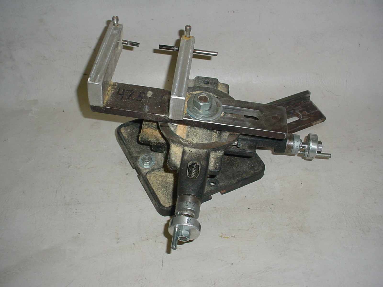

Kevin Beitz Posted December 30, 2019 Report Posted December 30, 2019 I made one... It uses round solid carbide cutters. Gunny 1 Quote
