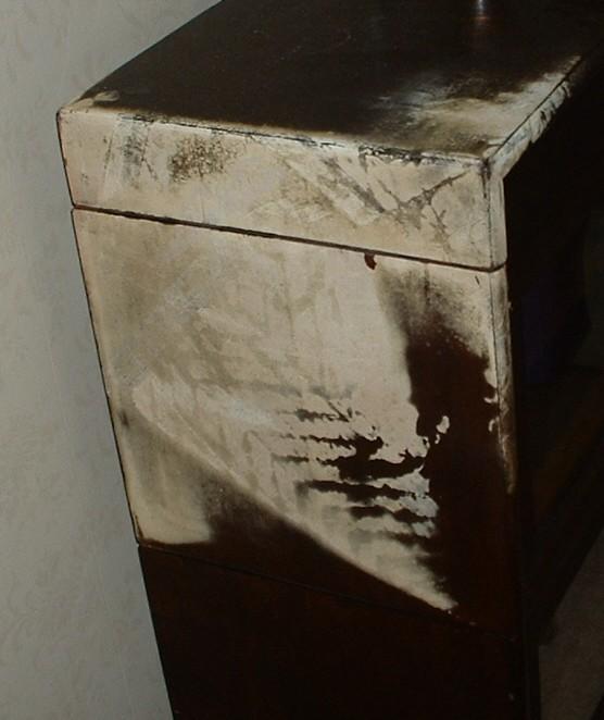

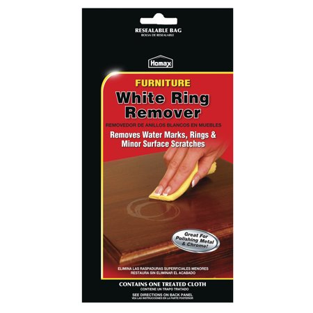

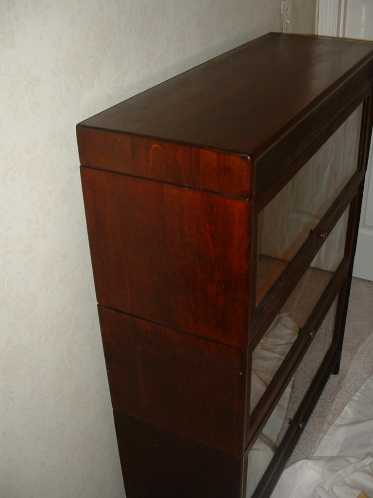

December 30, 20187 yr Popular Post comment_171854 There are a whole lot of home remedies. I've done many like this professionally, many quite worse. What I use is Jasco or Homax stain remover cloths. The only difference between them is the name and color of the packaging. It will make the surface a bit glossy, so you may have to do the whole top. Alternately, you can spray on some touch up lacquer when done to get the sheen of choice. It has some tallow acids (fatty acid) so it leaves the surface a bit oily, clean off with some Guardsman furniture polish or a cloth dampened with naphtha. Available a lot of places like the big box stores, Wal*mart, etc. Sorry for the absence, getting a brief break from hectic life. Edited December 30, 20187 yr by kmealy Report

December 30, 20187 yr comment_171917 If those "before & after" pics don't convince you, I don't know what would! Glad to see you Keith Hope to see you again real soon. Report
