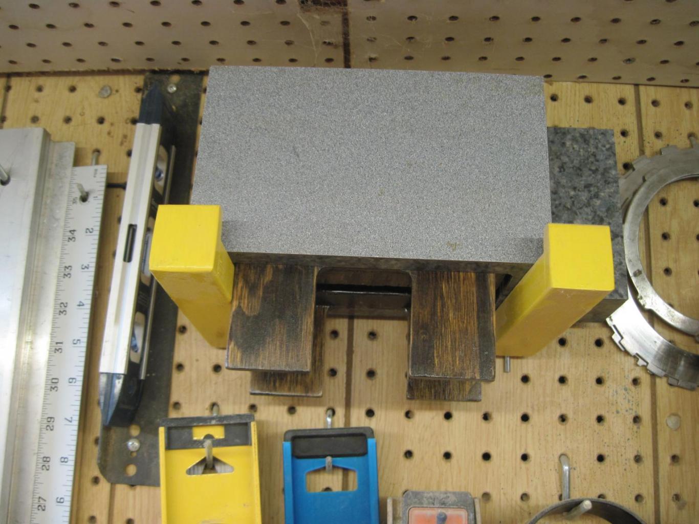

December 27, 20187 yr Popular Post comment_171388 Manufactured a few of these for myself few years back. Neighbor dropped by for some welding work and asked about making a few for his wall. Thought I would share the idea. I made the length to what I needed and drilled a hole just bigger than the hook. Then ran across tablesaw to get the right kerf for the side. Put a small amount of silicone in the hole and inserted the peg hook. Once cured they will come out, but you have to work at it. Possibilities are endless for shape and design. They give you the advantage of a removeable pegboard hook with more of a shelf than just the width of a hook. Report
