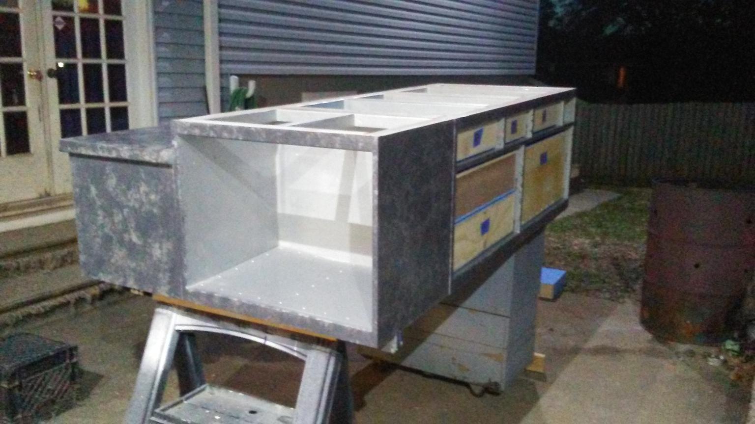

Popular Post Gunny Posted December 12, 2018 Author Popular Post Report Posted December 12, 2018 Last years shop organization project, only one I did. Enjoy cry, laugh, whatever, be inspired! Twin Tablesaws, one for regular cuts the other for dados. One fence, both saws squared to that fence. You DON'T want to know how long it took to make. HARO50, Artie, LarryS and 3 others 5 1 Quote

Popular Post Artie Posted December 17, 2018 Popular Post Report Posted December 17, 2018 I am a greenhorn to woodworking, just started build a shop in my (very small) basement a couple of years ago. One of the things I learned is that building the shop can be as much fun as making something. Your shop looks awesome. Gunny, Dadio, DuckSoup and 4 others 7 Quote
Gunny Posted December 18, 2018 Author Report Posted December 18, 2018 14 hours ago, Artie said: One of the things I learned is that building the shop can be as much fun as making something. Your shop looks awesome. I agree, get as much enjoyment out of making things for the shop as I do stuff I need in the house or yard. Thanks!!! Cal and Artie 2 Quote
Grandpadave52 Posted December 18, 2018 Report Posted December 18, 2018 On 12/11/2018 at 9:52 PM, Woodbutcherbynight said: Twin Tablesaws, one for regular cuts the other for dados. One fence, both saws squared to that fence. You DON'T want to know how long it took to make. That is one fantastic, well done super-saw. Wish you had been here then to take us along that journey. Certainly would have been an interesting thread. Cal and Gunny 2 Quote
Gunny Posted December 18, 2018 Author Report Posted December 18, 2018 16 minutes ago, Grandpadave52 said: That is one fantastic, well done super-saw. Wish you had been here then to take us along that journey. Certainly would have been an interesting thread. I have pictures from start to finish. Turned out to be a real masterpiece, for me anyway. Enjoy using it a lot!! Cal, LarryS, Artie and 1 other 3 1 Quote
Grandpadave52 Posted December 18, 2018 Report Posted December 18, 2018 Really like your handles...well done...what's your out feed extension material composition? Great detail touch adding the "dovetail" slot to match the saw table. I've seen a couple similar on You-tube and "locally" on CL, but yours is far and away superior. Sweet piece of equipment. Cal 1 Quote
Gunny Posted December 19, 2018 Author Report Posted December 19, 2018 16 hours ago, Grandpadave52 said: what's your out feed extension material composition? 3/4 ish MDF, laminate on top Braced the underside with 1/2 u-channel for added strength. Both halves are removable. Have to be, contractors saw when cutting angles above say 30 degrees allow the motor to swing up. The top is in the way for this. Rather than have one long and heavy piece I made two. 16 hours ago, Grandpadave52 said: I've seen a couple similar on You-tube and "locally" on CL, but yours is far and away superior. Sweet piece of equipment. THANKS, means a lot. Grandpadave52, p_toad and HARO50 3 Quote

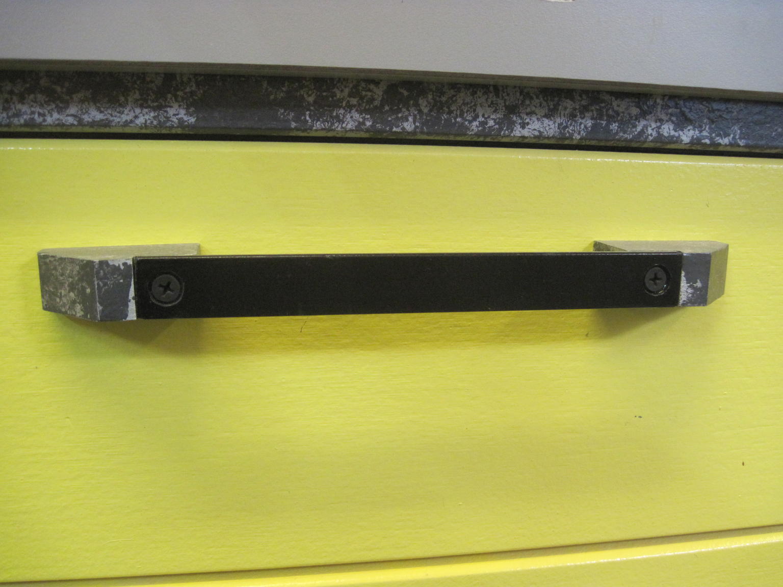

Pat Meeuwissen Posted December 19, 2018 Report Posted December 19, 2018 Really nice build, how much room did you leave around it to stand and work? Are the center part of your handles metal and epoxied to the stand offs? And lastly do you have a separate router fence, shop made? could you show it please. Gunny 1 Quote
Gunny Posted December 19, 2018 Author Report Posted December 19, 2018 3 hours ago, Pat Meeuwissen said: how much room did you leave around it to stand and work? Thanks for the compliment!!! About 36 inches or 92 cm. It is not really in exact center of shop. The saw is lined up so if I need to make a long cut I can open the double doors and run it through to outside. 3 hours ago, Pat Meeuwissen said: Are the center part of your handles metal and epoxied to the stand offs? No, I milled holes in all the flat metal then made a jig to drill through the wooden risers and into the drawer fronts all at once. Used #10 2 1/2 inch screws(6cm) 3 hours ago, Pat Meeuwissen said: And lastly do you have a separate router fence, shop made? Have not got to that as of yet. The summer / fall was spent working on a concrete block retaining wall project for a friend. Since you have mentioned it perhaps I need to get started? p_toad and HARO50 2 Quote
Pat Meeuwissen Posted December 19, 2018 Report Posted December 19, 2018 Thanks this picture of the handle is MUCH better. I like the jig idea to make all the handles the same height. And now its time to get busy on the router fence. Thank you for taking the time to answer my questions. Gunny 1 Quote
