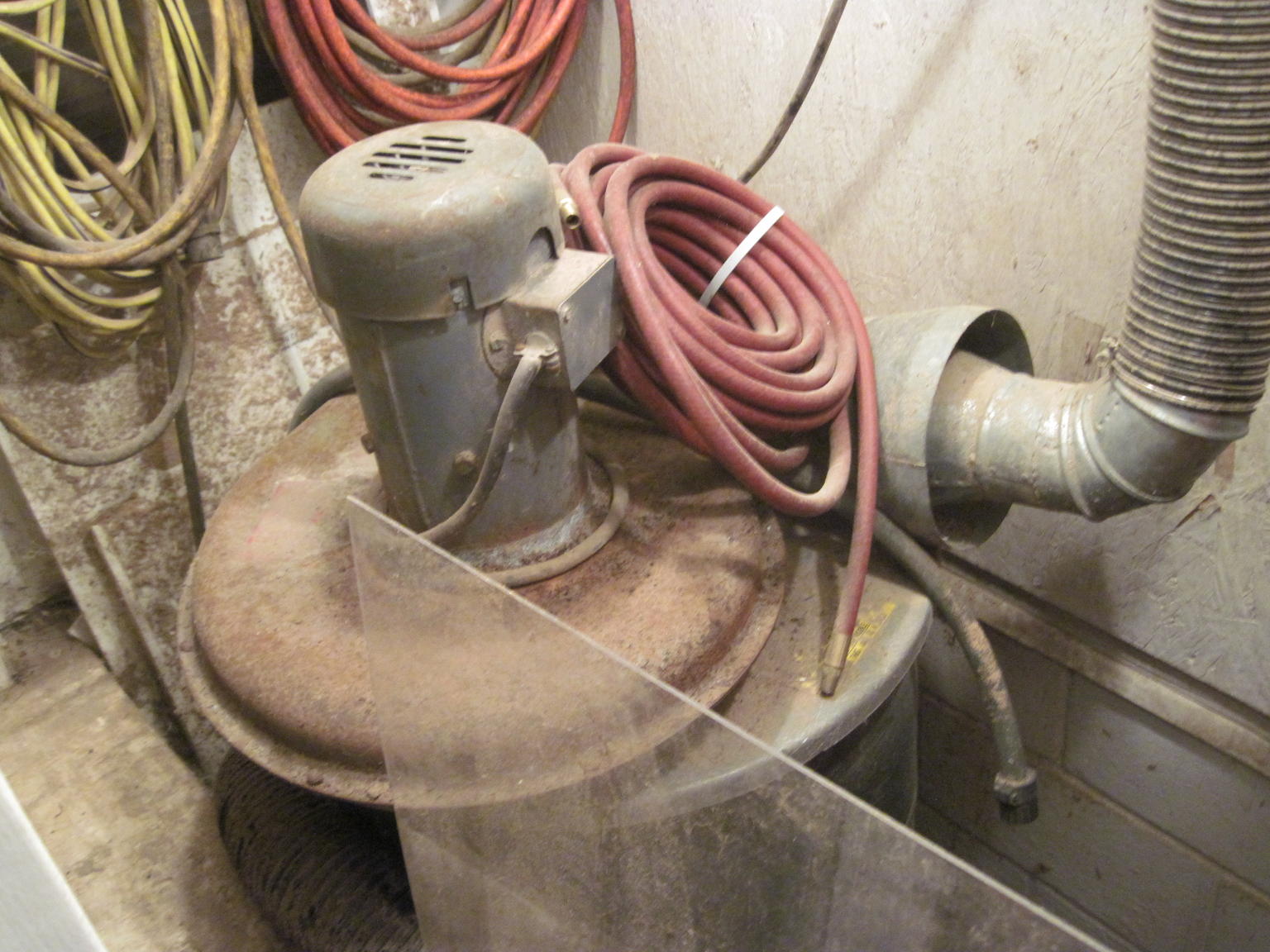

This is what I am using, vintage as in I got it from my Dad. But has worked for 20+ years in my shop.  Sits on top of a 55 gallon plastic drum.

I guess that you'd probably be ok with a 4" DC line. Interesting setup though, I don't see where the filter bag is. The DC hose on the right, is that where air and dust is coming into the DC ?  or the exhaust ?
Bag in on other side.  To get a picture would require some yoga moves this body has no business doing.  LOL  The hose on the right is suction side.  It can handle a large 12 inch hose, or as I have done smaller and adapted.

Ok, does the suction side go directly into the blower, or the container ? I'm not sure why I care, no one else seems to care or appreciate what I have done with DC's over the years.
Good question.  I cannot say I have ever looked to see how it works.  I hooked it up to the current setup in 2003, plugged it in and it sucked,

To empty the container I just lift the motor cap and perform some yoga moves to get it out.  Empty, okay some eloquent words are involved, then put it back.  Kinda cold and wet here so have to get back to this and take a look.  Having seen it last night I put it on my list of in need of refurb work.  Some paint will be in order and such.

That being said I will take a look and find out what model it is, HP of motor and maybe when it was manufactured.  I know my Dad had this when I was a teenager so it is at least 35 years old.
