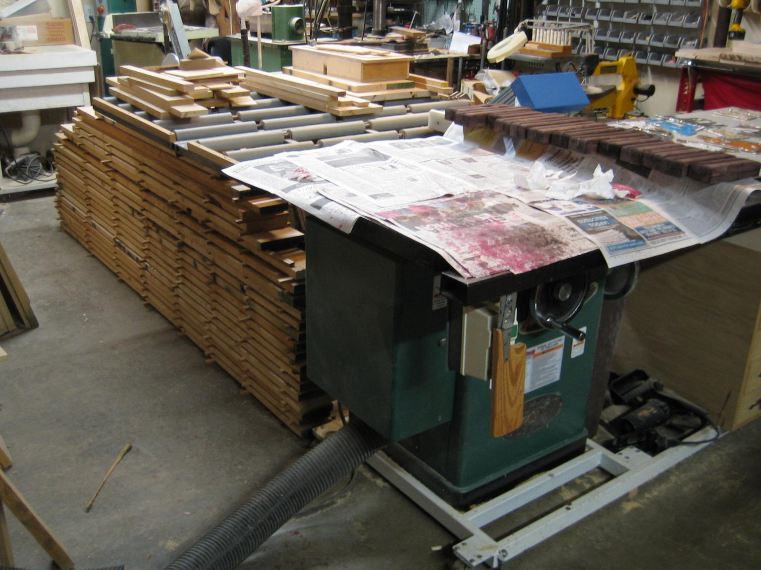

December 4, 20187 yr comment_168364 This is how I spent Saturday... It was a great day weather wise so the planer got lifted up on my rolling stand so I wouldn't have to bend over...Maw helped with the lifting... Just enough stacked there to lock under my rolling outfeed table. Last time I had some stacked there the stack got knocked over a few times... The brown stained bases are another set but 13 pieces this time.. she keeps finding more characters. This time she introduced the little Shepard to the group. Two of those boards are still in the ruff. I had stood them up cause they were the straightest then forgot they were there till I put up the planer... I then run a few through the joiner and glued a few together for this logo thingy. I am going to attempt to scroll saw the letters out and all the rest of the things so they will be raised somewhat then put it all back together. This is really a job for a CNC but I wouldn't know how to turn one on so the next best thing will have to do.. The biggest problem is getting a true blue on maple wood. So far it has been impossible since I been doing this for the last 60 years... I have every stain and dye and all the other things like water colors, acrylic, oil base and anything else any one in the whole wide world sells and it always turn green on maple... Report
December 4, 20187 yr comment_168366 That is a pile of boards!! I like the Power Off button on your saw. Report
December 4, 20187 yr comment_168369 26 minutes ago, lew said: That is a pile of boards!! I like the Power Off button on your saw. i'd paint it red, and with white lettering, i'd spell out WHOA. Report

December 4, 20187 yr Author comment_168380 Rusty, three stacks like that and I have to take the blades off and sharpen or else fork over about 50 bucks for new blades.. I do have a machine I bought new just for planer blades about 20 years ago and every set I take off the planer I practice sharpening but am still in the learning curve...I also have a Tormek but the only attachment I don't have is for planer blades.. Report

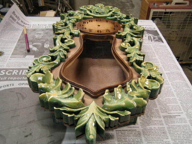

December 4, 20187 yr Author comment_168418 Cal when I first started out I did bleach a few and it is a chore and time consuming.. Mostly back then mahogany was very popular and I turned some big tv record player combinations and other mahogany made furniture into some beautiful maple finishes. I used all commercial wood bleaches and I haven't seen that stuff for many years. It gets too involved so the charges would be more than anyone would want to pay since there are lots of ways to actually hide the wood itself and fake it now. Cal that tall bottle with blue on it in the picture with the Bombay ink is boot and shoe dye. Years ago it was acetone or lacquer thinner thinned but now its water soluble. If a person starts with the commerical wood bleach and gets the wood almost to the desired tone I then can use house hold bleach at the end to help the cause but using house hold bleach only, no it don't do enough... Cal I appreciate all your help. I can't see anything new I haven't done before..Anytime you put a clear finish over what he is using things change. This is what I was after on this clock but after I applied clear lacquer, it changed to this. These two pieces are on this clock . I do all the carving in pieces then after the finish is applied I then glue all the pieces together on the backer board to hopefully becomes one carving.. Report
