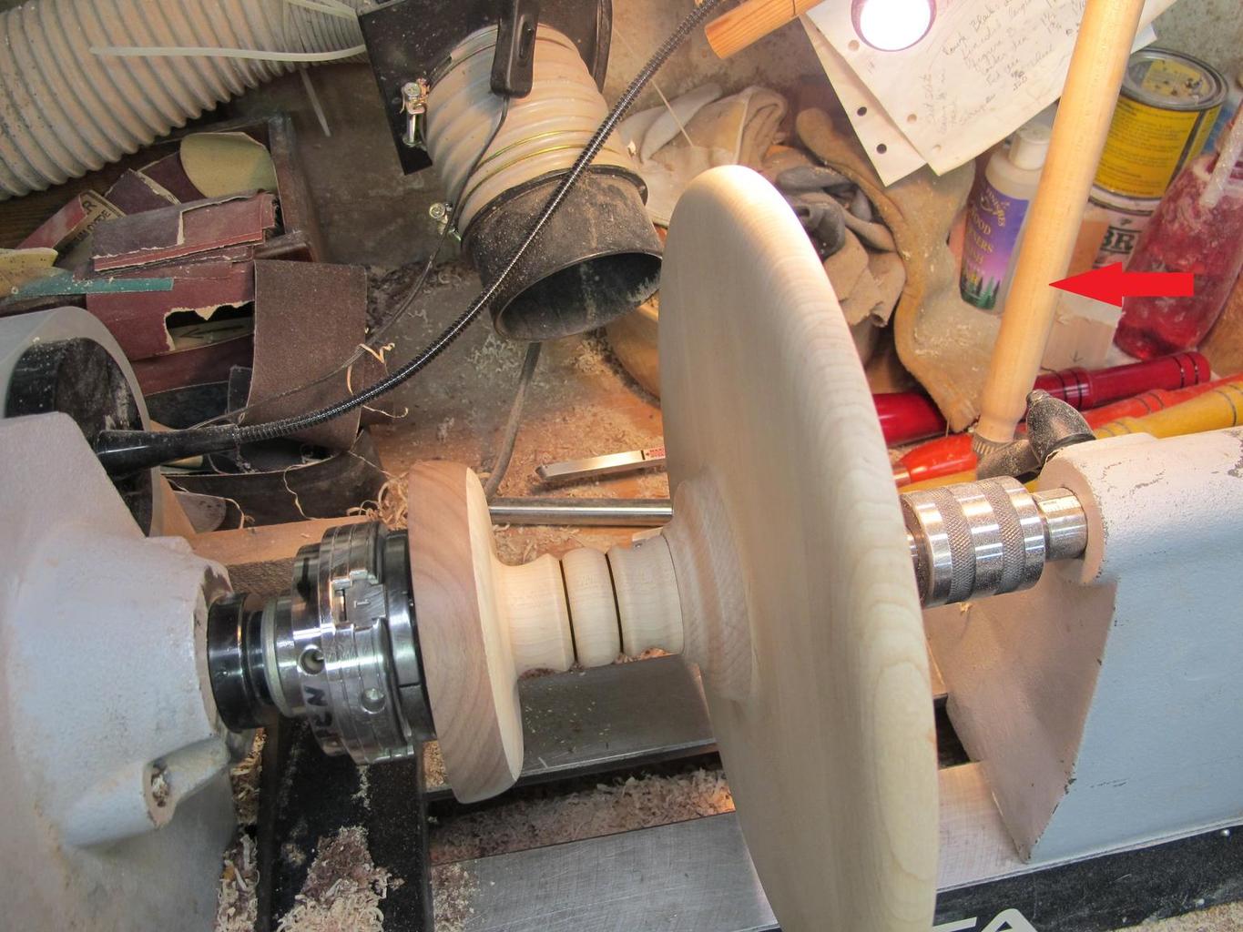

I had the same trouble with my Delta lathe. The tailstock would slide on the ways when I applied pressure.
I found that I couldn't get enough torque on the short lever used to tighten the tailstock down. I made an extension handle that slips over the original handle. It makes the total length about twice the original. Much easier to operate and provides more torque/pressure.
I split the lower inch or so of the hollowed handle and used a hose clamp to secure it to the original handle.
