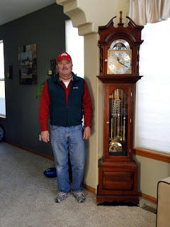

Popular Post Ron Altier Posted November 6, 2018 Author Popular Post Report Posted November 6, 2018 (edited) I built a large grandfather clock for my daughter years ago (picture below) and it would not longer than a year and I tried all I knew. I got a pro in and he said I did everything right, but there was a binding in the mechanism from the factory. He fixed it, cleaned oiled and adjusted the chimes. As we talked I asked how it looked, as I had been cleaning and oiling. He said I was doing a good job and all looked great. He said that he has seen clocks that were sprayed with WD40 and other cleaners. he said"Don't ever do that" At some point it will nearly impossible to clean the gunk out without a sonic cleaner. He said the dust and particles adhere to the WD40 and make a big mess. He also said something that surprised me. The new synthetic oils they make allow a clock to go as long as 8 years, depending on how much dust/dirt it is exposed to. As for the grandmother clock I am working on, I think I finally got it adjusted correctly, it took hours of cleaning, oiling, bending, adjusting and cussing Edited November 6, 2018 by Ron Altier sp HARO50, Cal, Dadio and 2 others 5 Quote
lew Posted November 6, 2018 Report Posted November 6, 2018 1 hour ago, Ron Altier said: Don't ever do that Oooopppsss! You clock looks a lot like mine except mine is in red oak. Cal, HARO50 and Dadio 2 1 Quote
