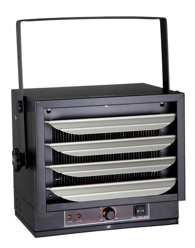

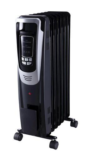

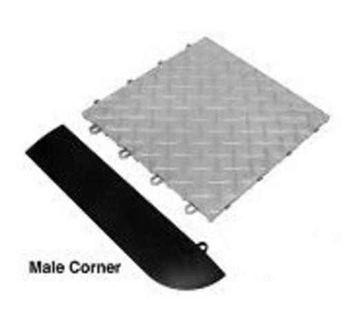

November 2, 20188 yr comment_165069 22 minutes ago, Michael Thuman said: The proposed heater will be 220V electric. Michael, are you talking about a garage type (dedicated) heater something like this? What square footage are you trying to heat? How cold does it get when the Lake effect snow doth blow? If you're just trying to keep the chill off (~55o-65o) maybe a couple of these strategically placed. Portable, 110V, nothing exposed, dust or fumes is not an issue and easy to clean. Since it's radiant heat, it also heats the air and objects. If you haven't already, might consider placing some of these mats and transitions on the floor where needed. For me, I know if I can keep my hands & feet warm, I'm usually good to go with a flannel shirt...sometimes a sock hat since my natural protection there has diminished. Report
November 2, 20188 yr Author comment_165071 Yes Garage type but positioned at the end of my shop so it covers all the metal tools and me. Room size is 24 x 50 shop is 12 x 30 on one side. Band saw and Mitre saw in front of router and table saw then come jointer and thickness planar in back. Don't want to heat air just tools and me. 65 would be grand. The block wall next to the shop would also act as a heat sink. Report

November 2, 20188 yr comment_165076 You would certainly have no worry about any fire hazard with an electric heater of that type, but I think what Dave said about using a couple of 120V floor models might work just fine for what you want. They would likely have to be on separate circuits. Edited November 2, 20188 yr by Fred W. Hargis Jr Report
