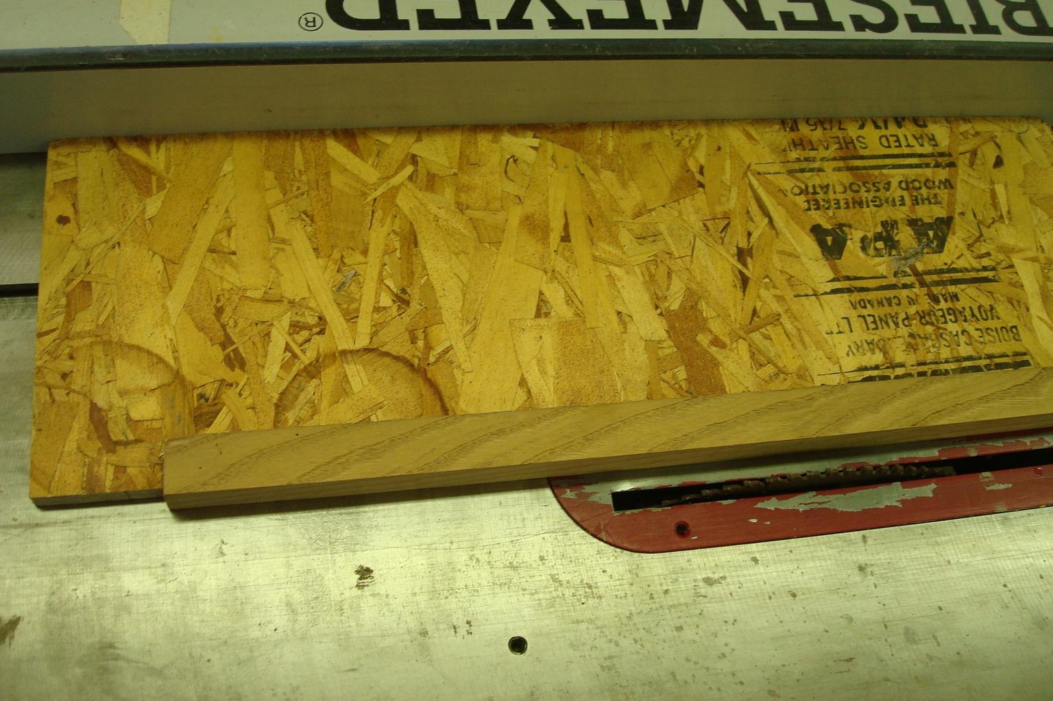

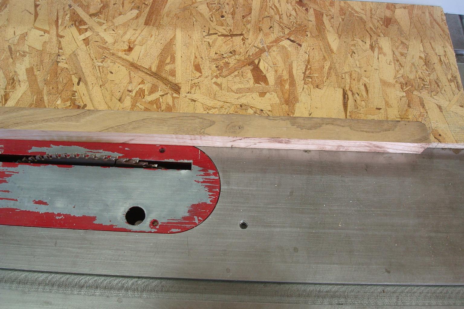

October 16, 20188 yr comment_162869 A couple of days ago. I was ripping 1” strips on my table saw. I use my right hand & the push stick and my left hand pointing finger. I put my finger on the wood between the blade and the fence about center of blade and rip. I started the cut and about half way I felt the end of my pointing finger getting hot. I looked and the end of my finger was on the blade but below the blades teeth. It was just rubbing against the flat surface. I moved my finger back a little and finished the cut and looked at my finger and there was a very tiny piece of skin and my finger was a little red. It was hot. Back to the drawing board, I know what I should have been doing. I don’t have a TV, phone or radio to distract, I just moved my finger to far and almost. Preston Report

October 16, 20188 yr comment_162878 Hello Steamshovel Consider making an adjustable jig for the left slot. Adjust the jig to the blade on the right side for the thickness of the strip you want to cut. Place the fence on the right side of the blade and place your stock against the jig. Gently move the fence into position against the stock and lock it. Remove the jig and place a guide against the stock to hold it against the fence. Turn on saw, push the stock through, no fingers get close to the blade. Reset the fence and repeat. hat Report

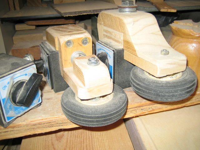

October 16, 20188 yr Popular Post comment_162881 I use my fence on the right side of the blade so thats whats wrong with the pictures and if I tried it like you show I might be missing a finger or two!!. Glade you are okay and now you have more to think about each time you get near a table saw.. This is what I use to keep the wood against the fence instead of my fingers Report
October 16, 20188 yr Author Popular Post comment_162890 3 hours ago, hatuffej said: Hello Steamshovel Consider making an adjustable jig for the left slot. Adjust the jig to the blade on the right side for the thickness of the strip you want to cut. Place the fence on the right side of the blade and place your stock against the jig. Gently move the fence into position against the stock and lock it. Remove the jig and place a guide against the stock to hold it against the fence. Turn on saw, push the stock through, no fingers get close to the blade. Reset the fence and repeat. hat Thanks for reminding me. I went out to the shop and made a jig. Preston Report

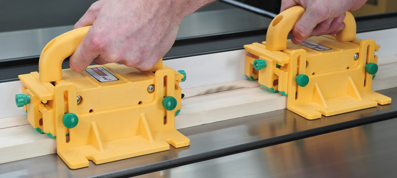

October 30, 20188 yr comment_164616 WOW - close call. My cousin lost 3 fingers doing similar to what you were doing. Look into a GRR-RIPPER - I bought two to perform hand-over-hand cutting - especially for narrow pieces. Best investment I could have made https://www.microjig.com/products/grr-ripper Report
