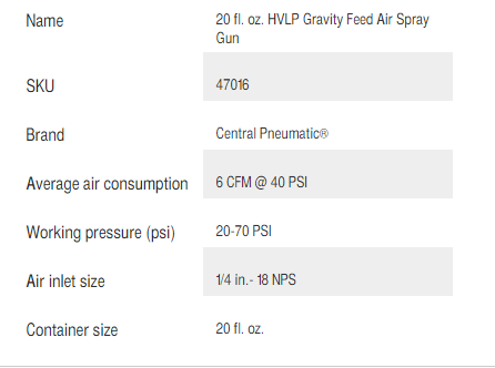

October 15, 20188 yr comment_162762 6 hours ago, Michael Thuman said: What is the CFM requirements for this gun? Per H-F site specs on this gun Report
October 17, 20188 yr comment_162975 So what size compressor would one use. My pressure is in the relm. The flow rate 6 CFM seems really low for HVLP. Report
October 18, 20188 yr comment_163001 I run a 33 gal Craftsman which has the following ratings: 8.6 CFM @ 40 psi 6.4 CFM @ 90 psi Max HP 6 150 psi Running HP 2 This compressor is one of the older ones. The newer compressors have a lower CFM rating. I would be hesitant using a smaller compressor. Danl Report
