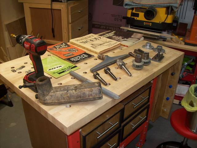

September 27, 20188 yr comment_161034 I kinda cleaned up my lathe today. I didn't do a strip cleaning but I don't think I will paint it. I am missing the rod that knocks whatever you have in the headstock out. The cup center must be a MT#1 because it's too small. I am assuming it should be a #2. There are no markings to tell what size it is. So where is a good place on the net to buy lathe things? I also need some cutting tools and I think I would like the new carbide cutters. I don't want to get into sharpening because that can run into a lot of money and it adds another learning curve . Report
