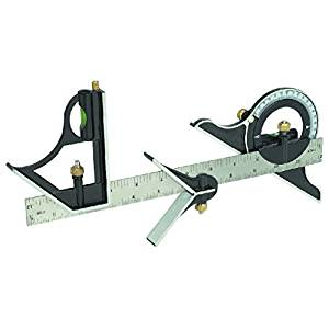

Gerald Posted August 31, 2018 Report Posted August 31, 2018 I Tried the homemade and it just did not make the good mark. I use the one Lew posted, but there is another way. lew 1 Quote
